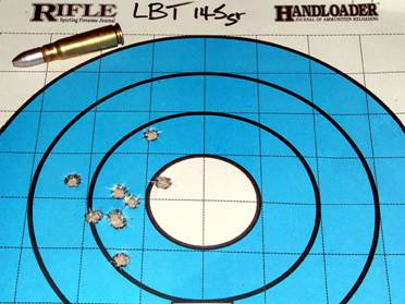

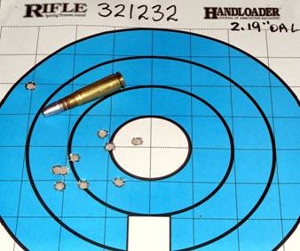

I used my Shooting Chrony Model F-1 to test the LBT 145gr. cast bullet as well as the venerable Lyman #321232 (175gr.). The load was 14gr. of WC 820 in once-fired Winchester brass atop Winchester Large Rifle primers. Ambient temperature was 25 degrees [Fahrenheit] and the chronograph was 15 feet from the muzzle.
Velocity Standard Dev. Extreme Spread
LBT Bullet, OAL = 2.125” 1,514fps 40fps 137fps
Lyman #321232, OAL = 2.19” 1,473fps 29fps 107fps
Targets
10 shot groups at 50 yards
