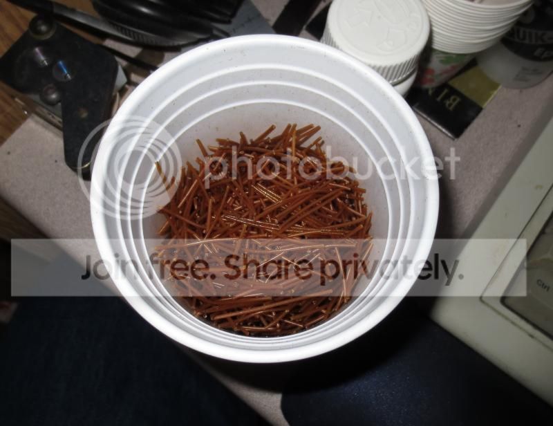

I bought 50rnds of WW2 surplus 303 British from the Carp gun and hunting show. Tried to fire some and only one round went off out of a dozen or so I tested. Decided to pull the bullets for reloading since the primers appear to be duds after 70 years. I did keep 5 loaded rounds since it's still sorta neat to have 1943 head stamped ammo. The cases where loaded with cordite as I thought they might. Brown strands, about 1.5" long, burns like any other smokeless powder. I was wondering if it can actually be used for something other than fertilizer or Canada Day celebrations.
.312" diameter bullets with cardboard wads under them. What I thought was a cannalure turned out to be inside the neck, not at the mouth, and filled with grease so I guess these are some of the greased bullets I've read about. A few also have markings stamped in the exposed lead on the bullets base. Some have an "H" and some have an asterisks (*); no idea what those mean. It appears to be solid lead so I'm pretty sure they aren't tracers.
Nice. I've fired cordite rounds but have never seen cordite in the metal. Not that I've spent any time looking for it either. How many strands? Did you count or weigh a charge? Did the round that did go off feel like a good military round?
I didn't count or weigh so the stuff is useless to me without some sort of weight data to go from. I wasn't really thinking of reusing it but the thought crossed my mind after the fact so I figured I'd post up here. They where packed in pretty tight and I had to use tweezers to pull the first few strands out to loosen it up enough for the rest to fall out. The recoil felt the same as the Winchester Super-X 180gr PP ammo I had out the same day but I'm not very recoil sensitive to smaller differences in recoil often go unnoticed to me.

They look like uncooked chow mien noodles but slightly thinner:

Cordite would be pretty tough to reload in a bottlenecked case. It was dropped into the straight bodied case before the neck and shoulder were swaged. that is why you had to pick some strands out before it loosened up enough to just fall out.

The very high percentage of Nitroglycerine in the original formula caused flame temps that were very high.
This resulted in accelerated throat erosion when a steady diet of cordite was on the menu.
Later formulations reduced the NG somewhat and added other components which lowered flame temps somewhat.
We have it good today....our smokeless propellants are relatively easy on barrel steel, compared to cordites.
