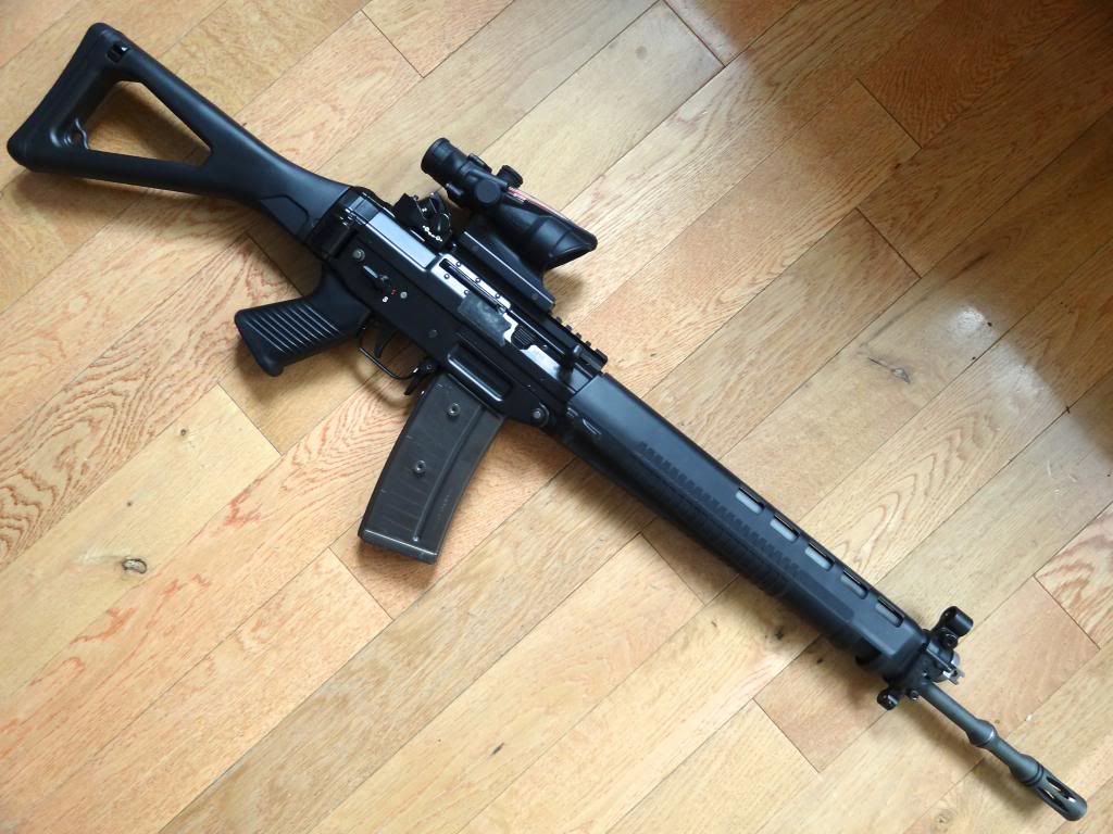

I'm toying with the idea of getting a Trijicon for my Swiss Arms Classic Green and I'm wondering if anyone has run one. From pics on Google I see that the ACOG should clear the iron sights. I am specifically wondering if the bullet drop compensator for the hash marks are accurate with the Swiss (they were designed for the M4 in 16-20" barrels with US military ammo)

Not all correct.. the only difference between the TA31 and the TA31F is the F has the red chevron , they are both for barrels between 16 and 20 . only the TA31RCO-A4CP models BDC is finely tuned to a 20 inch barrel and 62gr bullet .. I run the TA31F on my Swiss 20 inch barrel and the holdovers work perfect.. love it , main reason its the lightest most compact 4x optic out there , bonus on a already big heavy rifle. Im using a B&T top rail and the factory ACOG flat top AR mount and it just clears the rear sight ..
