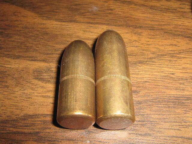

14.5 projo's (.585") 1000gr on left, 1200gr on right:

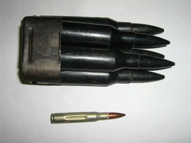

14.5x114 on PTRS 5 round clip. .30-06 dummy below for size comparison:

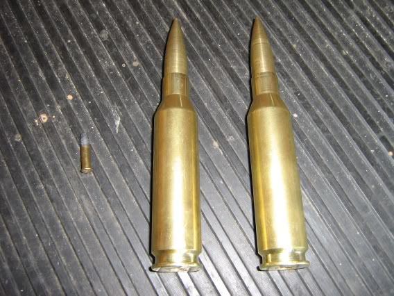

14.5x114 with .22LR (on left)

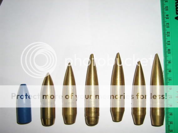

Various 14.5 projo's (blue one is 750gr):
