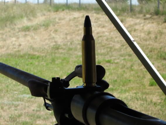

And my Baby bullets :D

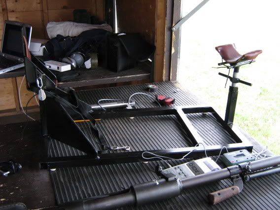

Custom built stand for the shooting.....
BTW... the strain guage system :eek: ..... worth every penny...:D :D
