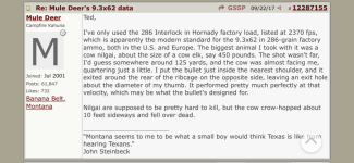

e yet to try any other loads/bullets. Also, I've I used the above data to develop loads for a safari to Mozambique last July. I could not safely reproduce JB’s 286 gr. Nosler partition load. Pressure appeared too high at 65 grains of Ramshot BG. I settled on 64 grains, and just over 2400 fps. Got the same results on testing Swift Aframes of the same weight. From my rifle’s 23” barrel. The biggest game I took with that load was a nice huge eland, bigger than any moose, which died quickly. I didn’t miss the extra velocity theoretically possible with some rifles.I found JB’s 9.3x62 load data:
