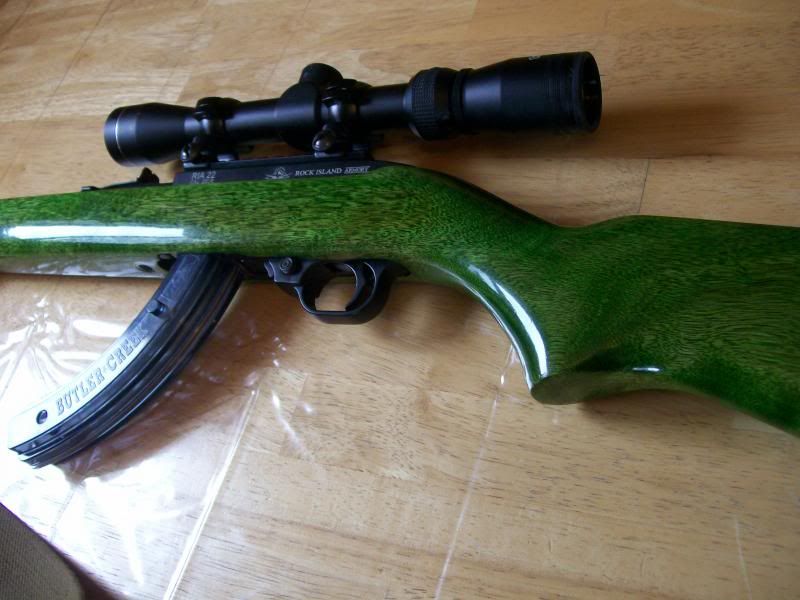

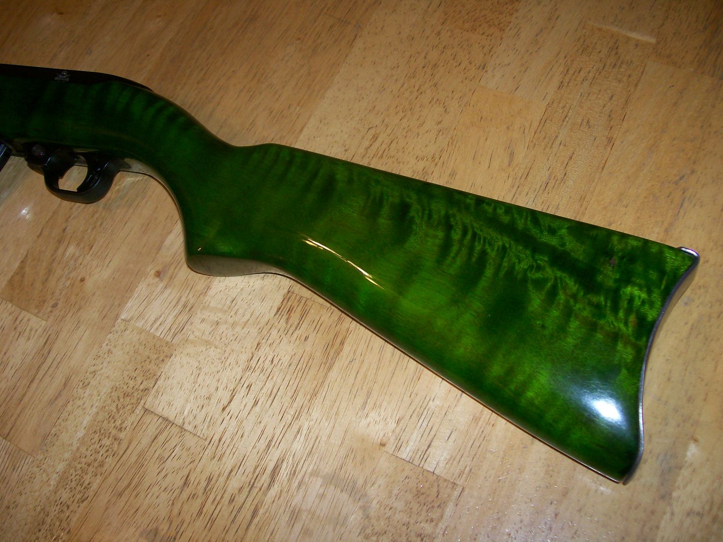

Here is a few stocks I colored and oiled using this method

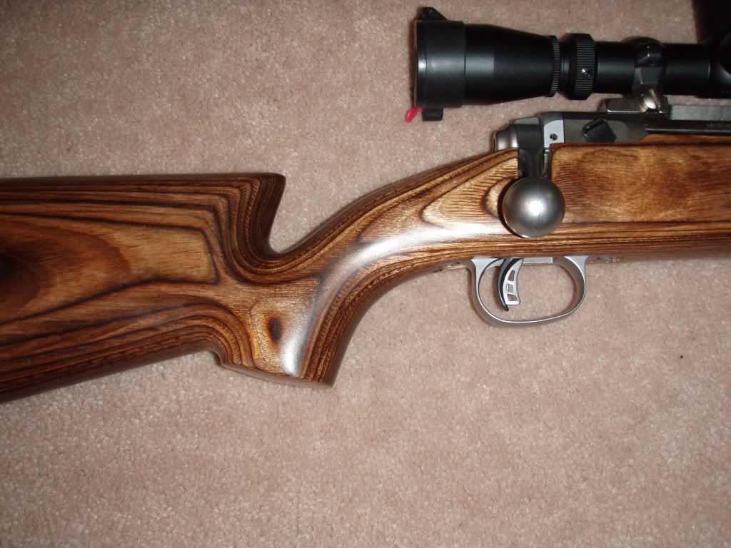

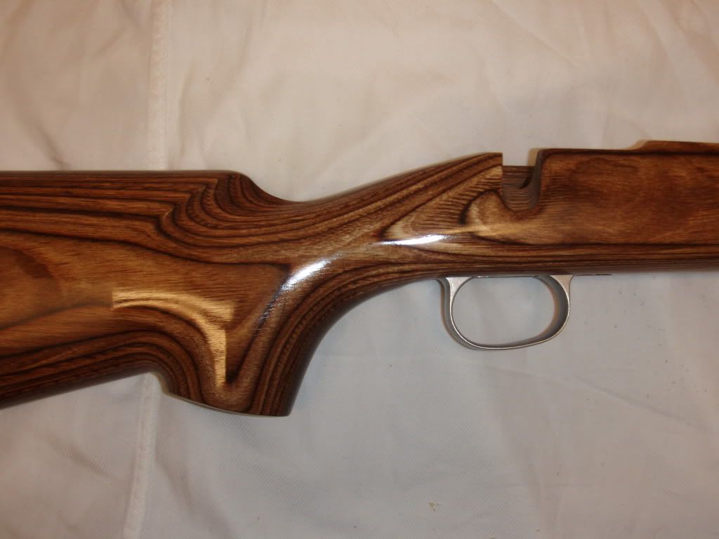

Not the best pic, but a 305 I just did. Looks new without looking "too new".

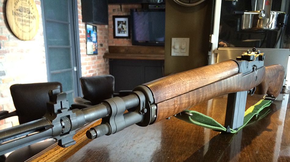

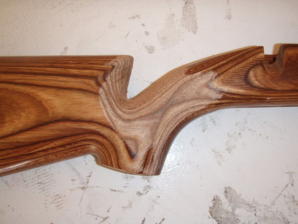

Several years ago I modified a factory laminate stock and was able to blend it all together nicely.
From this..........
to this...
..... and the final product.
The finish on the stock blended perfectly once I was done.
Thanks for the feedback, here's a few pictures. The more I look at the stock the uglier it gets maybe I should think about doing a full refinish. I bought this planning to get a second synthetic stock for it, turns out they are hard to come by for the 20 gauge. The intended purpose for this gun is to be the designated beater for when I don't want to take my nicer guns out-it will see plenty of marshes, heavy brush, and foul weather. Basically I intend to beat the $#!+ out of it. Lone Ranger - your guns are beautiful but I'm not sure I need anything that shiny.

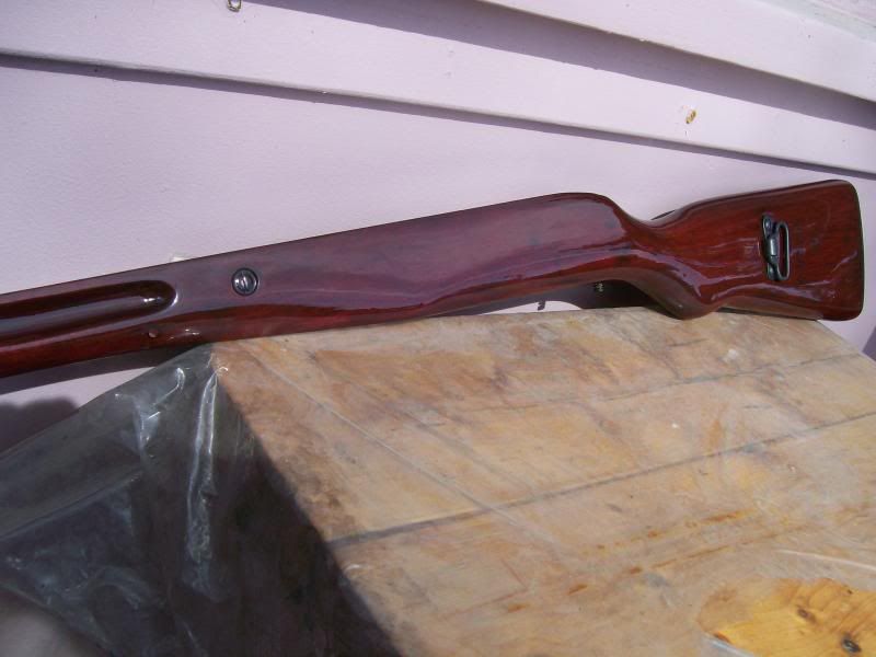

Surfcloud the second picture you posted, did you just sand that area down and then coat it with tru-oil several times? I like the look of it and I could probably handle that. Somerset I like your finish job too in fact I think I almost prefer the "duller look" as long as it is weatherproof. Did you just sand down and then follow the instructions you provided or did you use a chemical to remove the old finish. Would I sand the checkered areas as well? I could probably handle sanding the whole thing, doing a water based stain, and then 8-10 coats of tru oil with some wet sanding in between.
I might as well do it right. Can I start sanding or do I need to "strip" the current finish off somehow first? I'm going to the hardware store, ill buy the steel wool, the 1000 and 1500 sandpaper , some water based stain, and the tru oil. Anything else I need?
I'll post some pics as I go..inb4 I ruin this gun.

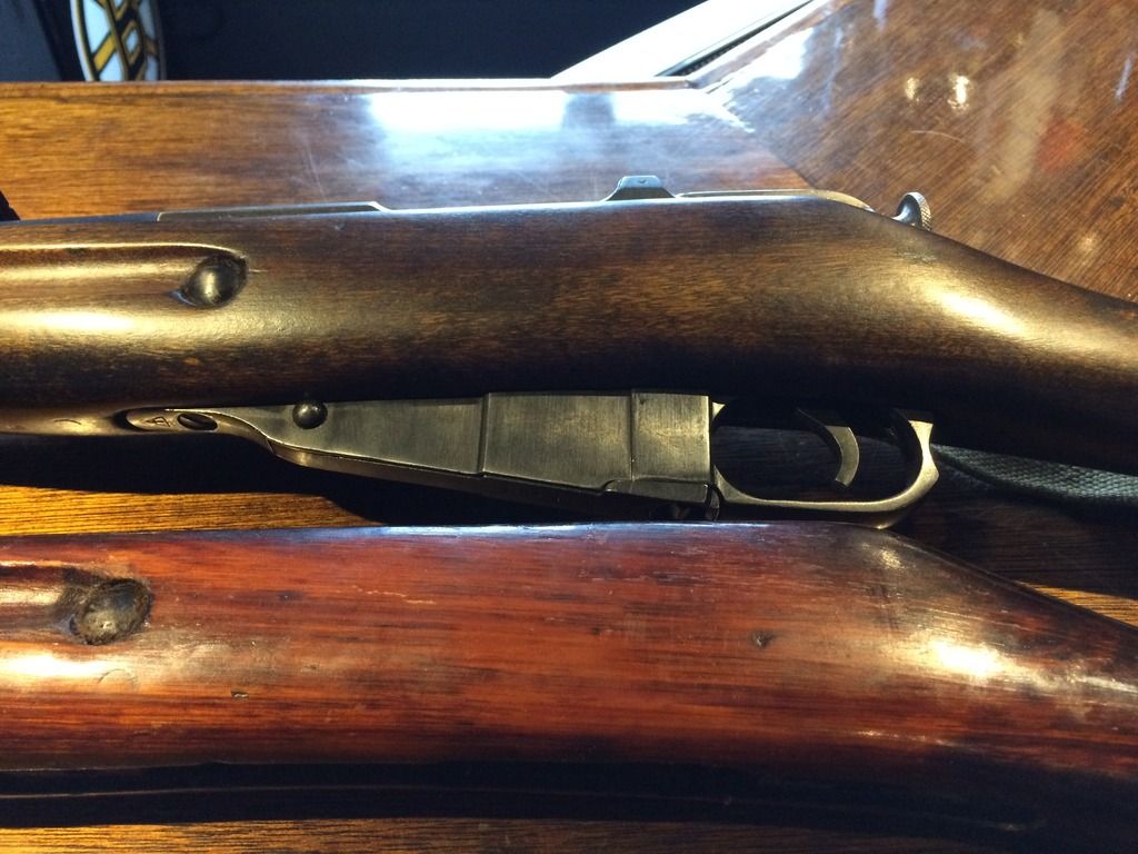

I didn't use any chemical stripper, I used just hot steam/towels and very low grit sandpaper foam sheets I get from lee valley. Honestly the thing that smells the most is the oil-based stain, everything else (including tru-oil) doesn't have much smell at all, and what it does have fades quickly as it dries.
My finish ends up satin, but oh-so-smooth to the touch. I've done a few for other people as well in exactly the same way, and the only reason I use tru-oil over the linseed oil I used to swear by (and still like a lot), is it seems to never get tacky on a hot day or over a hot barrel. In fact, I cranked 50 rounds though a mosin, and the top wood that was on the barrel didn't get tacky, it got the lightest "oil sweat" that wiped off easliy and cleanly (linseed oil also can take months to get a thick finish).

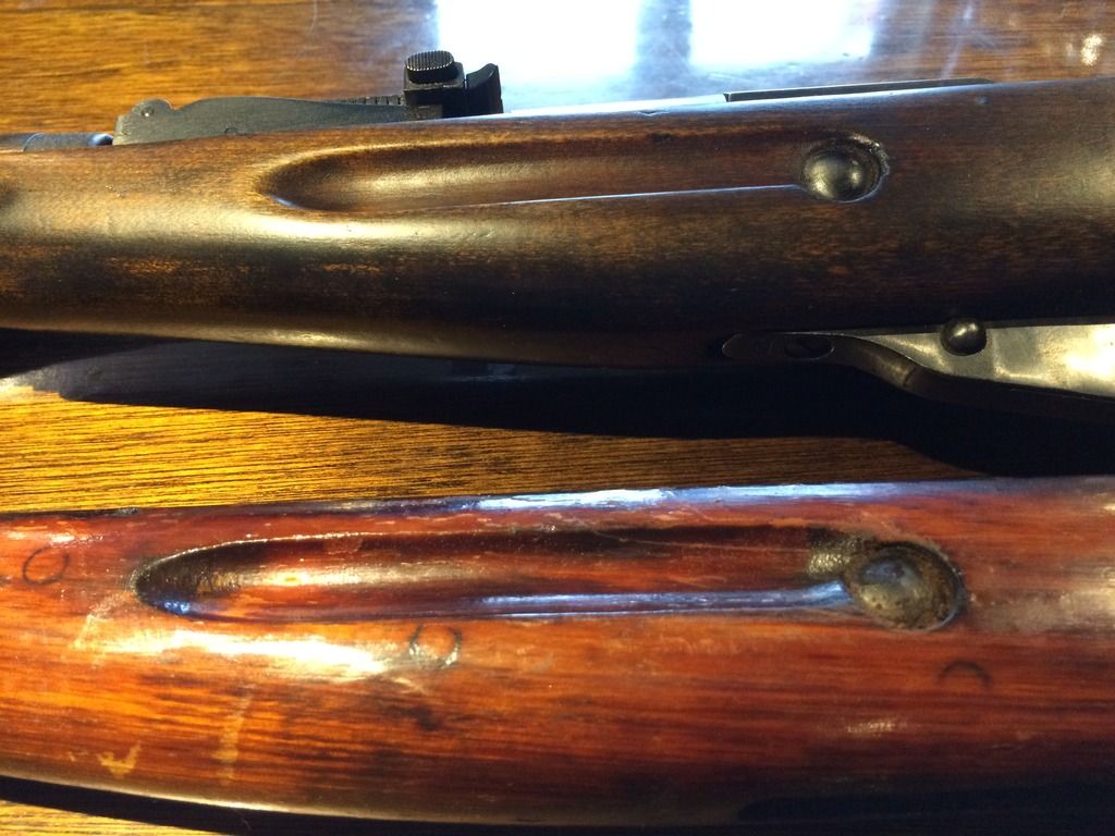

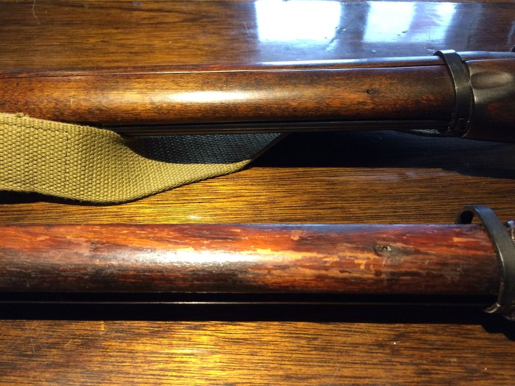

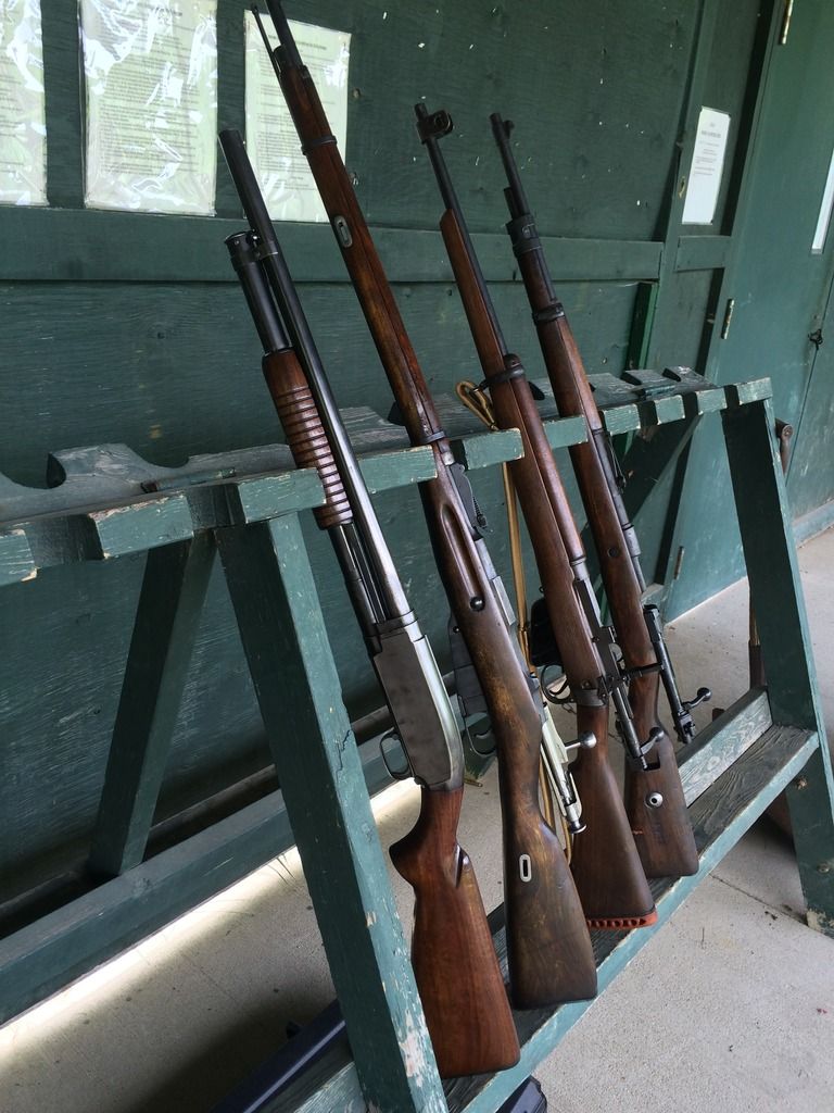

Here's three more I did the same way. I didn't touch the K98 in the rear, but I had a spare stock for the mosin (still have the original cosmoline stock), the enfield had been sporterized, and the pump shotty was in very poor condition (I left it a bit shinier).

Just so you know I'm not talking out my backside... here are the stocks. Now I shoot that mosin more than I probably should. I put 100 rounds through the svt-40 that bashes the brass up, and then reload and shoot them through the mosin to pop the dents out- and repeat. This is a very good shooter, maybe better than my enfield, but I wouldn't shoot it very much in that original stock. I take her out almost every time I go, and that tru finish is about a year old, winter-winter, and it's still really nice. Maybe in 10 years she'll need a touch up, who knows.
