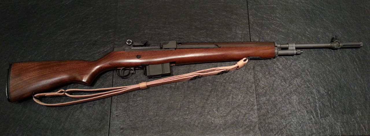

Norinco M305 with Italian walnut, finished in Tru-Oil (The picture doesn't do it justice. It's a gloss finish with the wood glowing and
shimmering with an iridescence):

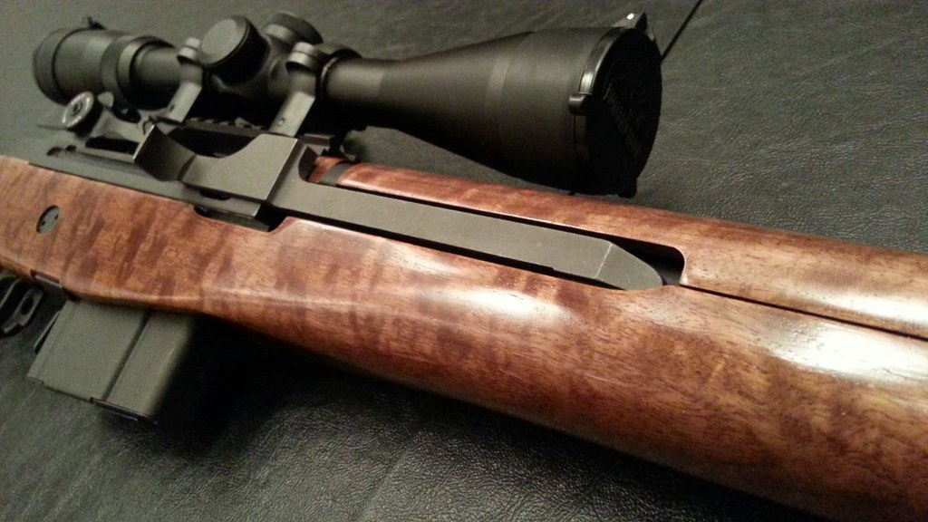

Norinco M305 with Boyd's walnut stock, finished in Circa 1850 Tung Oil (satin finish):

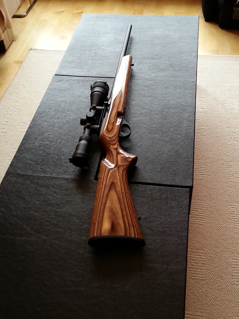

Remington 597 Laminate stock finished in Tru-Oil (gloss finish)
