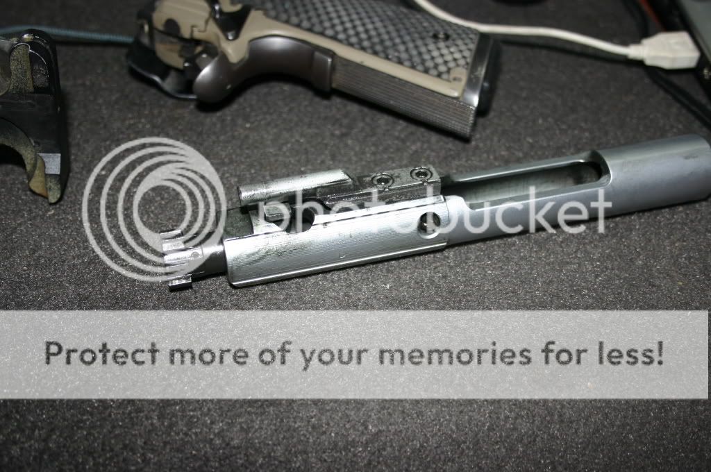

I took these pics -- I was at the range and fired 5 mags - 3 during a break contact drill - and the other two in not as rapid sucession.
150 rds -- pretty few in the grand scheme - and as such I did not bother cleaning it after the range.

All I did in the 10 minutes I cleaned it - is clear the weapon, take the upper off (I have a redi-mag so its easier to do that.
Pull the bolt carrier assembly out
Spray the inner of the upper and the barrel with the cleaner - let it sit
Strip the BCA - spray it - and wipe it (this time all I did is wipe the components - as the lube was still on fairly heavy and I just wiped off the dirty oil - and relubed.

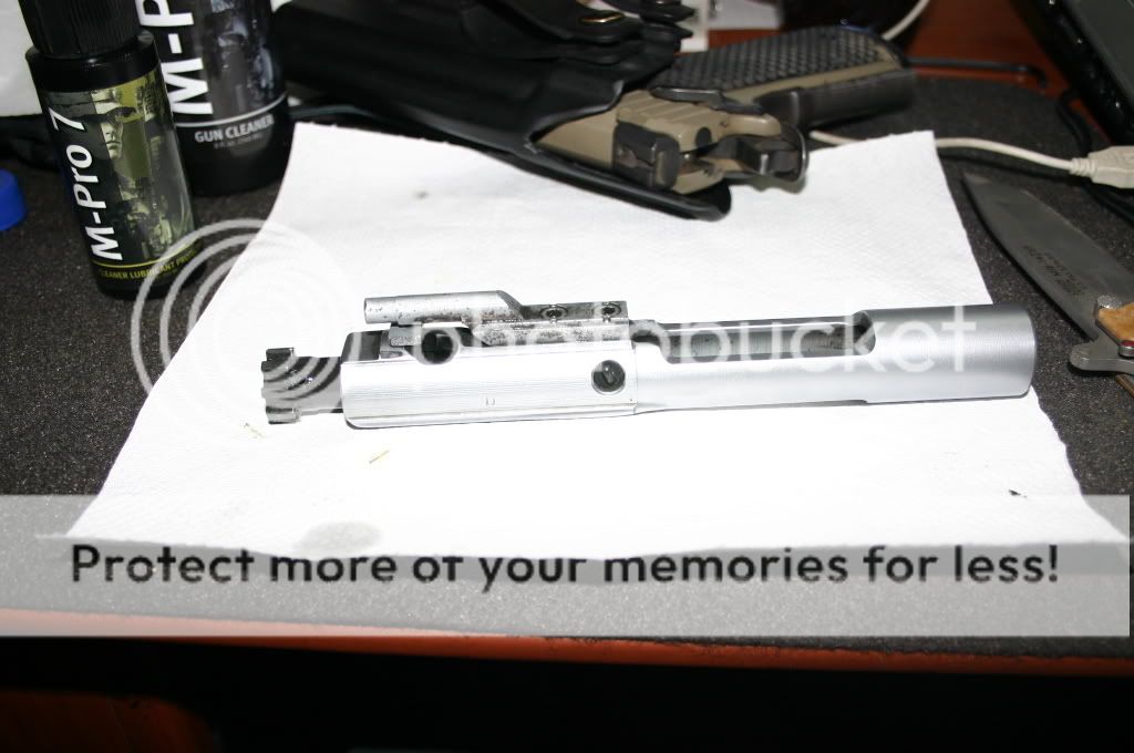

Right out of the upper
I put a piece of white paper towel down so the carbon would contrast.

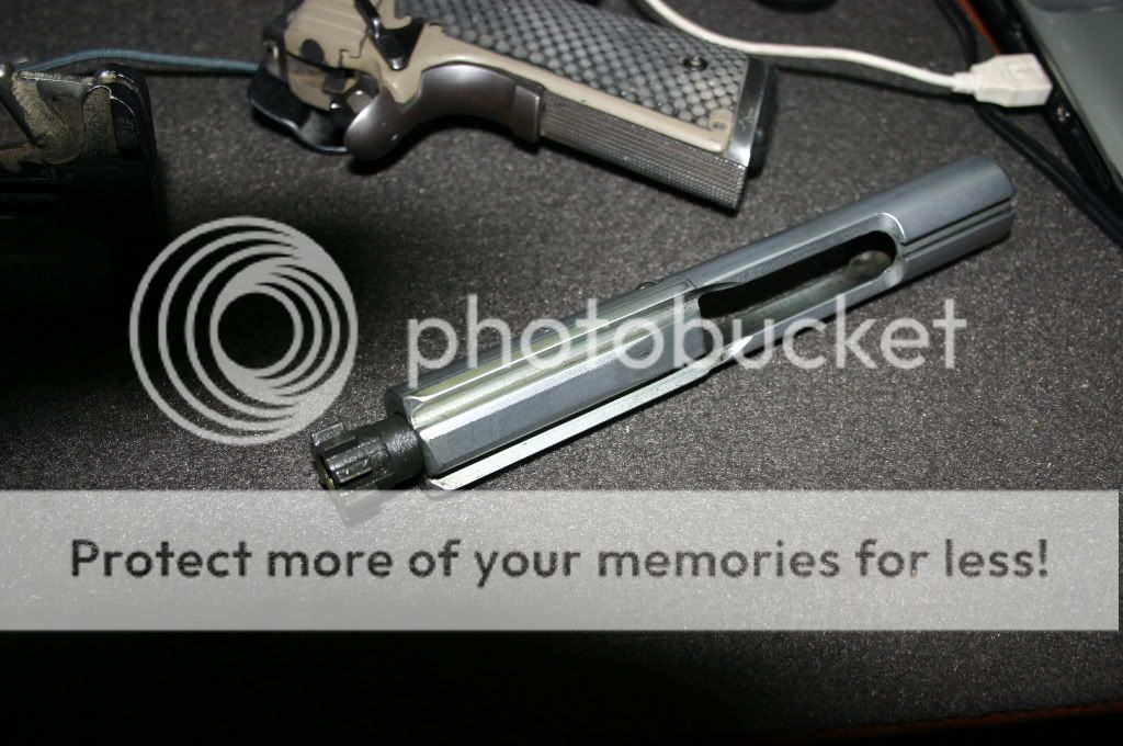

Pulled the bolt out

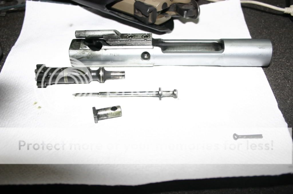

Took the extractor out

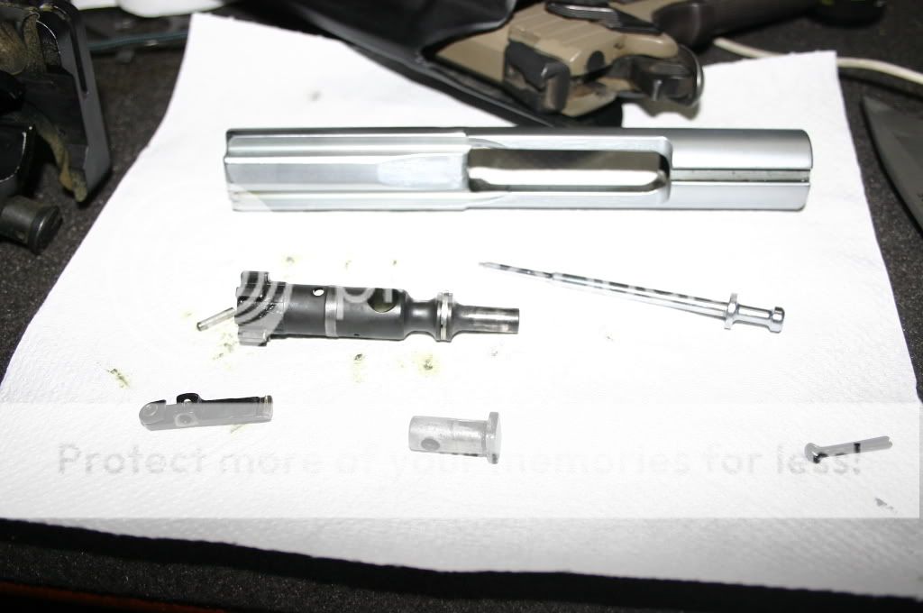

Cleaned and put back together
