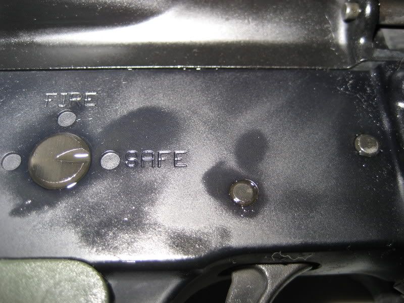

Test #3 - Look at your AR (assuming it is lubricated) right now and if it has oil on the outside around all of the pin holes you need a new lubricant. Yours is so thin it has seeped out and it not protecting your gun anymore. You can find the oil in the bottom of your safe or in your rifle case and grease at AutoZone.

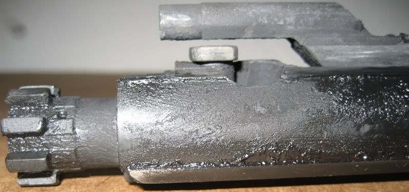

This is my bolt after a three day Pat Rogers Carbine class with NO cleaning and NO lubrication after the class began. It was about 1100 rounds (+/-). The $2.86 a tub high temp lithium wheel bearing grease from Wal-Mart worked like a charm...again. You can see it is pretty dirty but is still "wet" even with all of the rounds fired.
This is where your oil goes...it runs out of the gun:
Excellent pics........ very nice explanation.... That bolt looks pretty coated i must say. Never seen an AR one with grease on it before. :)
