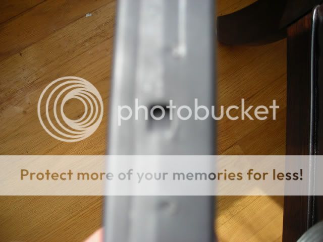

Here's how the mag is pinned(same thing on both sides). I guess, there's not much chance of taking it apart...
easy to take apart but forget it. DO NOT use this ammo its not safe in AR. what do you think would hapen if you chambered on of thoses round that got its head pushed in the case ??? use FMJ 55gr and up criped rounds
