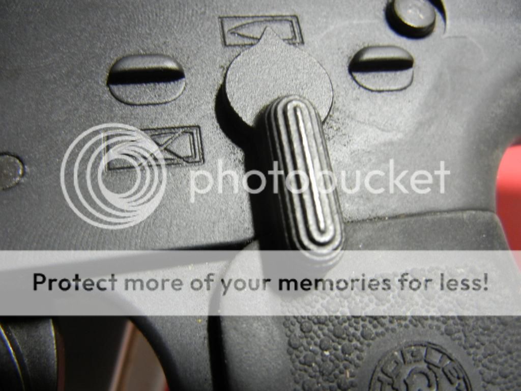

Safety would click into Safe, but would not click smoothly into fire.
Checked all the obvious things and took it to the gunsmith.
In 10 seconds he gave me a terrible look and pointed out that the lever was hitting the new rubber pistol grip.
Insert face palm here.
The new Hogue grips with the beaver tail have a recess to allow the safety to clear without issue.
But using a Dremel and a few minutes smoothing out that area and you will be fine.
