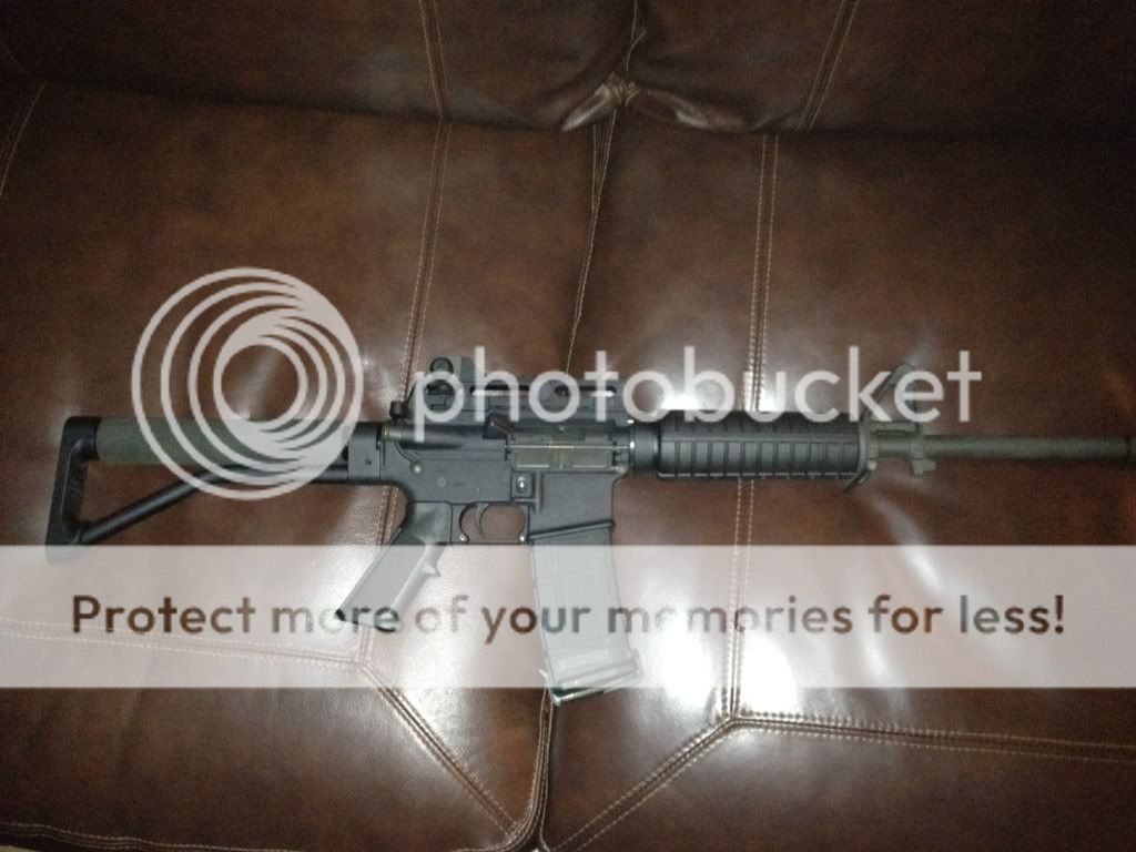

I Posted a while ago about my AR i cannot seem to get the Bolt to go past the Bolt catch not sure whats going on. I tried Shortening the Buffer Spring still seems like its hitting on something in the Upper..
Thanks guys. Its a Rock River Upper on an Armalite Lower.

not sure exactly what you mean but Tonight Ill take a picture of the Bolt when i take it of the Upper and Post it for all you Gun GOO ROOS. This is my first AR Build it worked fine then all of a sudden cant seem to get the bolt to go back all the way..

Hey guys these picstures are from exactly what I took out of my AR the BSG is all the way forward on the one picture you will see the bolt cannot go all the way back

Thanks guys the Rifle goes together fine.. I have had the bolt catch work properly with this stock and spring.. The gun fired Fine when i used it the first time... I guess Ill try and purchased a new Carbine Buffer Spring and see if that works.

Can I just cut my Spring down to a shorter length just to see if thats the problem then ill order the carbine spring. It really sounds like when i pull the bolt back like the BCG is hitting something in the back of the upper but it might just be there Stop on the Buffer Spring..

Thanks for the Wise advice. I was only considering cutting the spring to the carbine length to ensure that was the problem then I would Purchase the proper spring as there are not to many places around Northern Alberta for Parts. I measured the Buffer Spring it is exactly 12 1/2" the Buffer Tube is just shy of 10". Hopefully that will help to determine if I have a Rifle Sprong or the Carbine Spring
