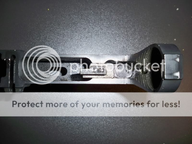

The Colt sear block was only in use from '91 to '95. Why people think it was the norm is beyond me. New Colt's also have small pivot pins and small trigger pins as well. No more weird compatibility issues with different uppers or trigger mechs.
Maybe I'm not understanding the term "block" correctly. Every LE6920 I've owned has/had the metal web in the way to prevent the auto sear from being dropped in. Now, I also had a Match Target Hbar that had a seperate block of metal dropped and fixed into the receiver. Is that what everyone is referring to as a "block"? Perhaps the term "auto sear web" should be added to the list then, just to indicate that there's still extra metal in there.
Web on a LE6920
Sear Block on a Colt Match Hbar
Colt LE6920 (top) and Noveske (bottom lowers)
^^^ Colt's had non-milspec sized pins for many years and was a common complaint among "purists". The '91-'95 time frame was apparently for the sear blocks like Cancer spoke of above.
Don't have exact years but all SP1 had large 2 piece pivot pins, normal trigger pins.
When they made the switch to normal size pivot pin they also switched to larger trigger pins.
It's only within the last year or two that they went back to normal trigger pins, not a huge issue as most aftermarket triggers can be had with larger pins.
cancer, I had seen that before, don't know what others call it but a "web" sounds more accurate.
