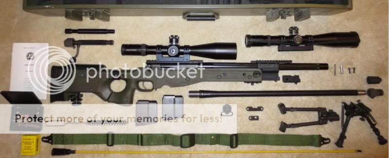

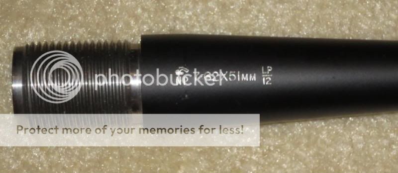

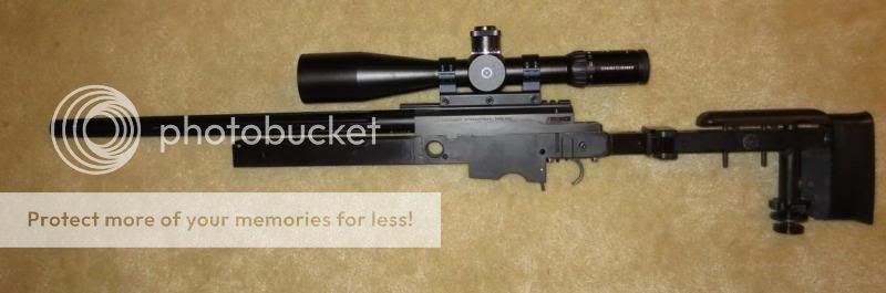

I've been saying for awhile now that I am planning to do an Arctic Warfare "project" - switiching to a longer barrel, adding a muzzlebreak, adding the handstop, getting rid of that NV rail, and basically returning it to a "military" spec, rather than the short-barrel police-type look. I had to order some parts from England. Anywhere, here is installment #1 in my "blog" about transforming my AW. Hopefully some people will find this somewhat interesting.
(This second photo was supposed to be larger, but the CGN site shows it as the same as above)

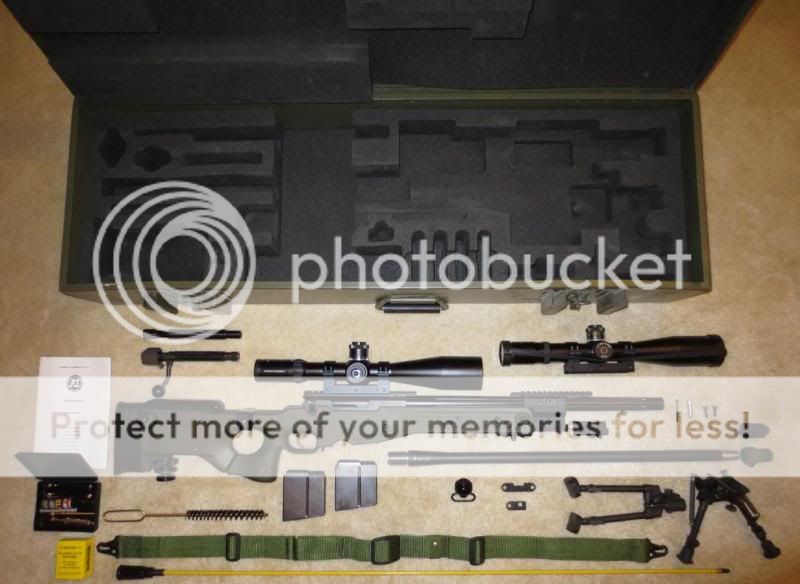

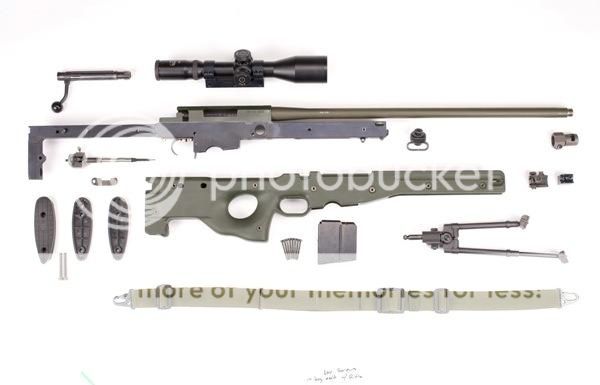

Items shown here: Transit case for folding stock rifle, manual, cleaning kit, Parker Hale patches, platic bore guide, bolt, AW308 rifle with 20" fluted barrel and IMUNS rail, bore brush, sling, cleaning rod, Schmidt & Bender 12-50x56mm PMII, two AW .308 10-round double stack mags, Schmidt & Bender 4-16x50mm PMII with AI one-piece mount, 7.62x51mm threaded barrel 26" long, hand-stop with sling loop, long and short ling attachments, block for mounting the PH bi-pod, Parker Hale bi-pod with rubber feet installed, Harris bi-pod, muzzlebreak, cap for muzzlebreak, hardware.

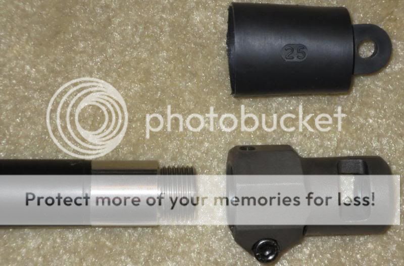

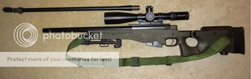

New barrel. The rubber thing is a cap for the muzzlebreak.

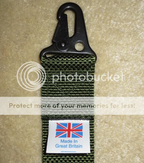

Proudly made in Great Britain! :) You don't see a whole lot of that in the world of firearms these days.

Here`s a cell phone pic for now, will try to get some better ones in a few days.

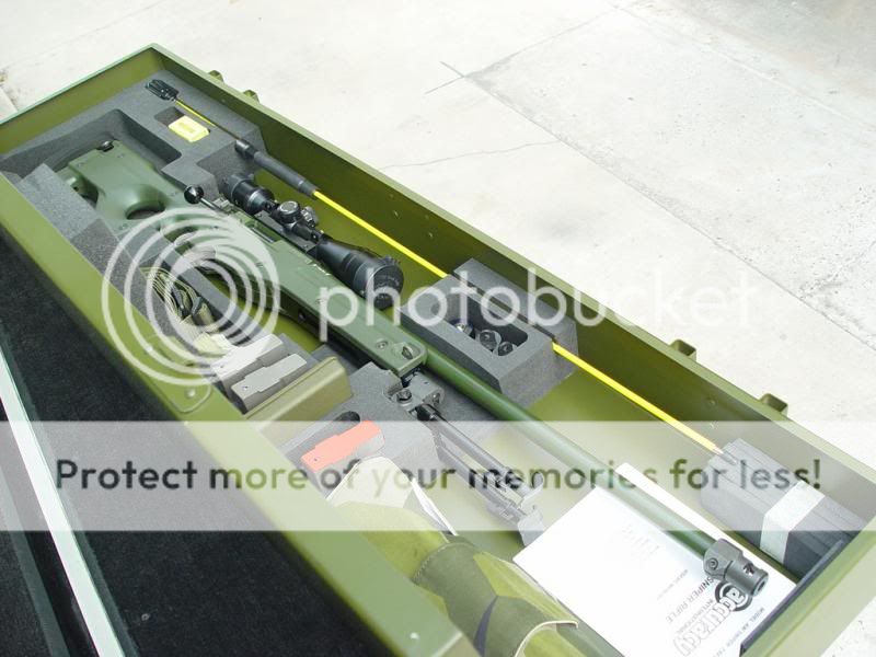

Gotta love these AI "box" photos:

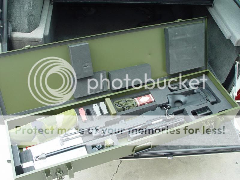

These things are so "neat", even the Bundeswehr loves these transit case shots:

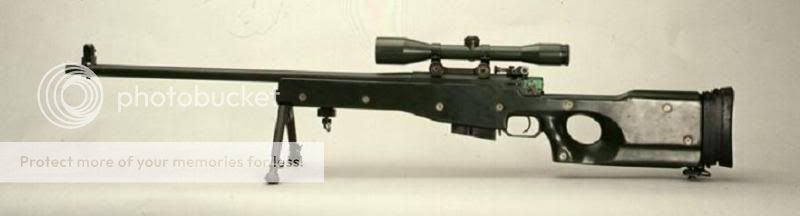

This is the type of rifle he has: Precision Marksman or L96A1 (adopted in 86, not 96, but, that`s what they call it), reproduced from a book I have. Note the green receiver, green fixed 6x S&B scope, no muzzlebreak, no adjustable cheek rest, etc. Definitely a relative of today`s AI rifles, and pretty far ahead for almost 30 years ago.
Here's a better picture of the L96A1, showing the proper scope and mount, etc.

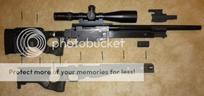

Stage 2 of the project:
This photo shows the right side panels taken off. The IMUNS rail has six screws in the top, and then the top part comes right off. The Harris bi-pod adapter screws into two threaded holes in the bottom of the "insert" part of the IMUNS rail.

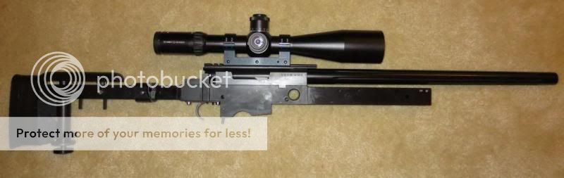

All four stockside pieces are now gone, and the IMUNS rail is gone too. It is removed simply by drifting out that large shiney role pin.
Other side. You can see the obvious difference between these rifles and the AICS system or the AE rifles. The action is permanently screwed and epoxy bonded to a large aluminum block that runs almost the length of the rifle. As this is a folding stock model, there is an (incredibly robust) joint in the aluminum block.

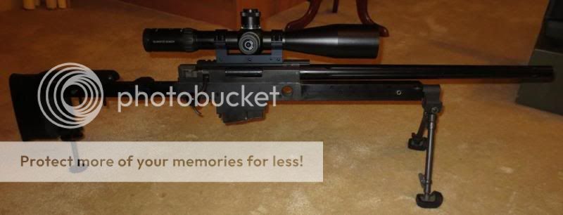

Now the new (original style) bi-pod mounting block has been inserted, then the front ambidexterous sling loops go in, then the silver roll pin. For this picture I put the bi-pod back on, the bolt and mag in... and that is pretty much what the rifle looks like minus the stocks. Note also that the picatinny rail is "scalloped" on the bottom near the barrel, so it comes nowhere near the barrel.

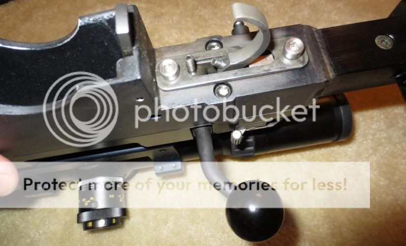

Here is a close-up of the trigger without the stocks on. The screw directly on the trigger is the take-up. The other one is, what I would call "tension". I'm not sure what the gunsmiths actually call them.
