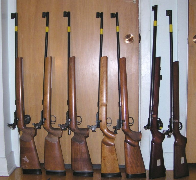

I have quite a few Anschütz rifles.
Two are marked as a "Mark 12"
One is almost exactly as another one marked as a Model 2000, see this link and note the acorn shaped bolt shroud.
http://jga.anschuetz-sport.com/downloads/Ersatzteile/EN/ET_Mark2000_1982-05-01_EN.pdf?downloads
The other is a Junior Achiever rifle that also use the acorn shaped shroud.
These bolts are shorter the the 64 model and are not interchangeable with the 64's(CIL 180 &190's)
The Mark 12 and Model 2000 below.
With Cil 190's

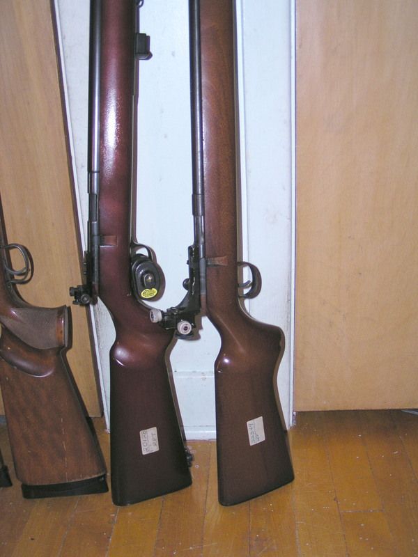

This shows the acorn/wasp waisted bolt shroud on this Achiever.
With Cil 190's
Holy smokes, no wonder 190's are hard to find, you have them all, LOL.
Seriously nice collection. I belive the Achiever and m2000 are called a Flobert II Action, if I'm not mistaken, and it's smaller action than the 64. Here is a picture I took from another sight comparing the actions.
64 action has the bolt handle in line with the trigger. Lesser actions, the bolt handle is ahead of the trigger. In the US there was a Woodchucker with the lesser action, although very well thought of as a quality shooter.
