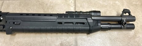

modified the barrel clamping arms(shortened) of the heat shield to clear the action bars, had to modify the rear forend adaptor to accept the heat sheild barrel clamps(no need for a ranger band to secure it) Mag tube nut needs to be removed to gain access to the heatsheild screws & heat sheild screws & clamp need to be assembled before mag tube nut is reassembled.
Modification to the bottom heat sheild barrel clamp to clear the mag tube nut, I also cut off one of clamping assemblies.
You will also need to glue a heat resistant rubber to the bottom of the upper portion of the heat sheild(I used the rubber gaskets from the Tactical Ordnance/cut to fit)
The rubber takes up the space between the sheild & barrel allowing you to tighten the sheild to the barrel.(I believe it was about 3 or 4 layers stacked)
