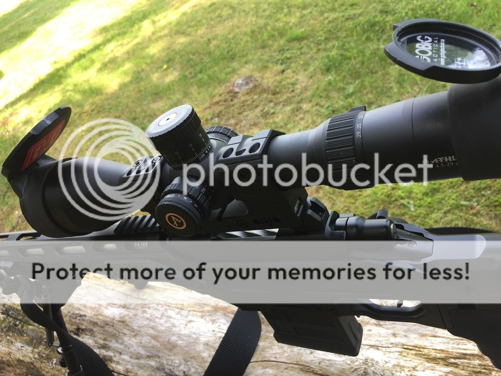

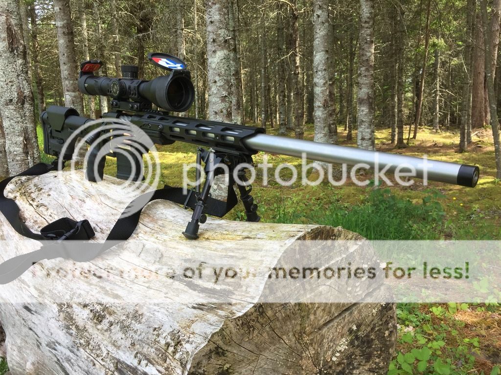

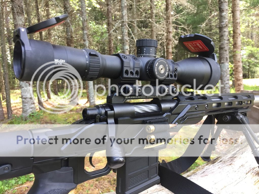

The Cronus is mounted in a SPHUR 0 MIl/MOA, on a Custom Rem700 in 6.5 CM. The base on the Cadex is 6mil/20 Moa (Sorry for the dirty rig, just finished a shoot with it)
It has a total elevation adjustment of 33+ mils (115 MOA), and 18+ mils (64 MOA) of windage adjustment. Windage and elevation adjustments are 0.1-mil per click ( It is also avalible in MOA)
And as it is important to many, with the scope mounted as it sits, I have a total of 23.6 Mils of USABLE elevation adjustment.
Its 35.8 ounces in weight and has an overall length of 14.4 inches. Making it not excessively heavy or long.

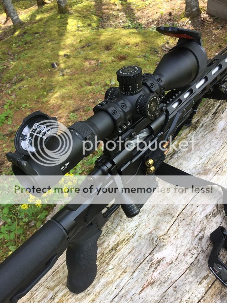

There were complaints of the turrets feeling "Mushy" however after doing some research it seemed that Athlon used a heavy grease under the turrets, once removed the adjustment clicks were very tactile and percise.
This scope has zero stop on the elevation turret, and the windage turret is non-locking.
The reticle is a nice xmas tree with that has numeric numbering for quick holdovers. It works well and is accurate.
I found the eye box on the scope to be extremely forgiving even at 29x. It does have a fast focus eye piece and parallax adjustment.
The magnification ring is on par with other high end optics, and is smooth and easy to turn. It does have a small switch-view protrusion built into the ring. Its not a full switch view, however its better then nothing and does help.
The one thing to note would be the parallax and illumination knobs are stacked, with the parallax on the inner ring, and illumination on the outer ring. The illumination has an off setting between every illumination setting and is day time visible.
The parallax adjustment is firm, but not stiff. It works as it should.
I should also mention that the zero stop is extremely easy to set, and appears to be robust and reliable.
