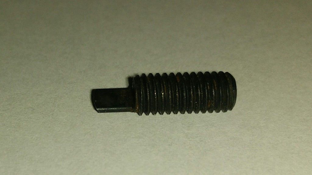

I have a question about the assembly of the rifle. When you seperate the upper and lower is the buffer held in place? Mine was not so when I reassembled I pushed the buffer in and held it in place by turning the retention screw then reattached the upper and lower. After I loosened the retention screw so if I disassemble again the buffer won't be held in place but there will be no screw between the buffer and bolt.
Am I doing this right or can the screw be left to hold the buffer in place and there is no need to use the retention screw?
I'm guessing your buffer retention screw broke, should look like this, the tab at the end hangs down and holds the buffer in place while the rifle is apart. I think you're doing the right thing as that will allow you to continue using your rifle until you can get a new screw.
Mine broke as well (and apparently one other before me). Not a big deal, atrs was great and quick to ship a free replacement. Maybe a stronger retainer is in order though?
My buffer retention screw broke in the first few shots. ATRS had a couple replacements in the mail before i hung up the phone.
I think i would agree, stronger buffer retention screws in order. That little tab isnt a lot to hold that spring and buffer in place.
Already on it!! We have found several rifles that this has happened in so have beefed up the updated version and the notch is a radius rather than a 90 degree cut so should be far stronger.
Dr. hunter
Leaving the screw out totally will NOT hurt anything. just makes take down a PITA.
However, turning the broken screw in to retain the buffer WILL do damage to the buffer due to a lack of clearance.
PLEASE call us ASAP so we can get replacement parts out to you.

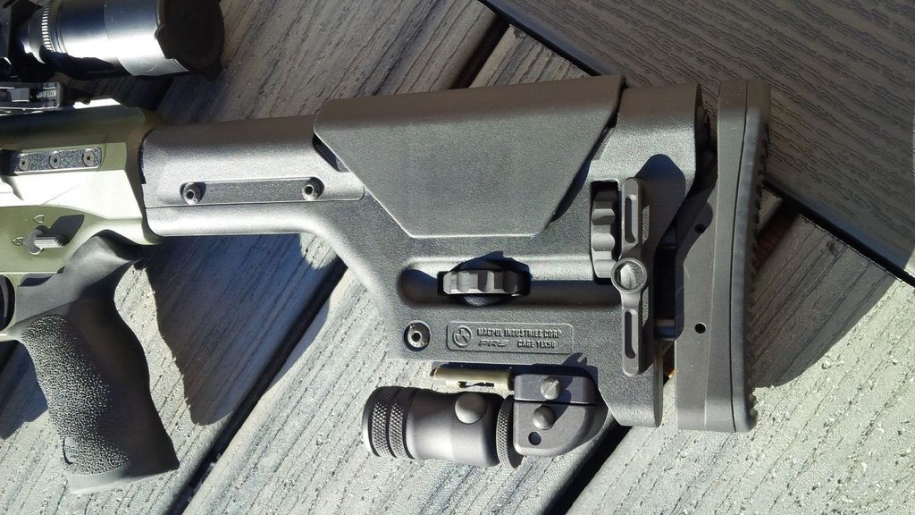

PMM (Parker Mountain Machine) produce this awesome QD sling mount made for the MagPul PRS stock.

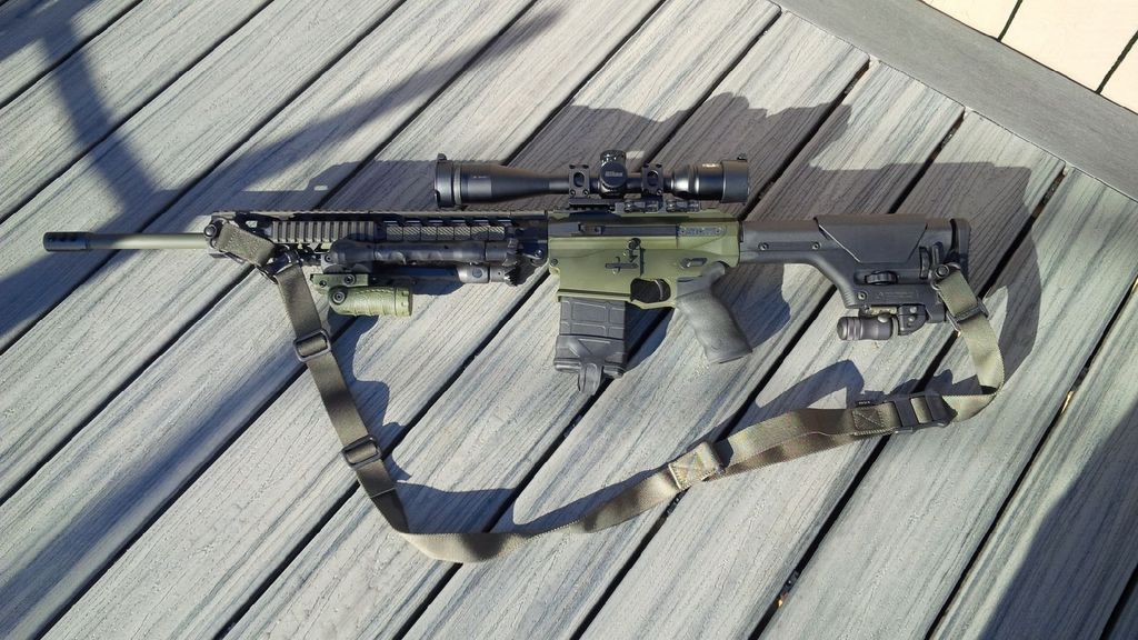

Ok, I got mine a few weeks ago and it is bare bones with the exception of a muzzle break, medium 18.6" barrel and "ambi" controls.
My targets have been with inexpensive AE 150gr and they are 1.5"-3" but that is probably me.
A lot of tight groups of 4 then the fifth goes a little off target - I guess I get excited easily.
I have to get used to my FFP Sightron, breathing, trigger control and recoil impulse / follow through.
These are huge factors of course but the accuracy is coming as I will shoot better quality product after the break-in period.
Which for me will be after 200 rounds or so.
The break does an exceptional job but it is very loud.
A recent arrival in the mail was the upgraded "Buffer Retention Screw" - Thanks ATRS.
I separated the halves and I quickly noticed that the old retention screw was in pieces….
The buffer face was scored (though probably by the spring??) along with the back of the bolt.
Installed the new screw and I will take it up to the range on Saturday to see how it all comes together.

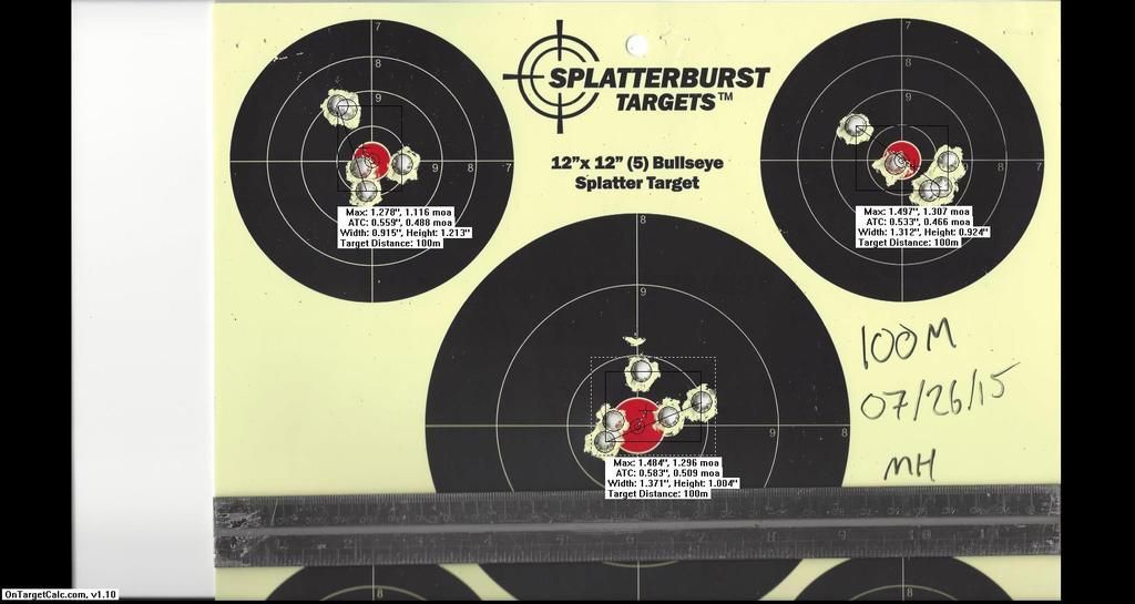

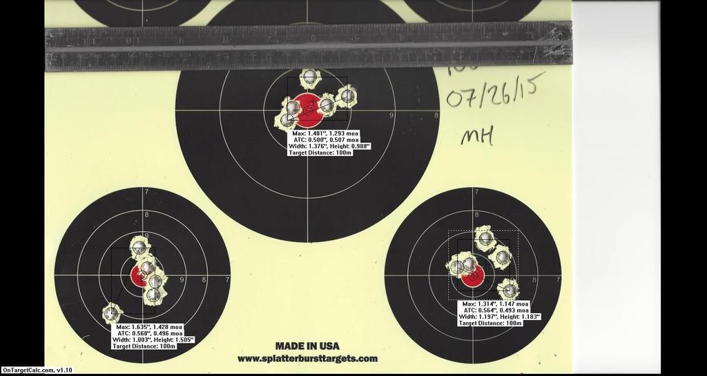

Well, I had a chance to head out to the range this weekend and got some quality time in behind my Modern Hunter. My reloading bench is still being put back together after renovating the basement, so I've been playing with factory ammo and the Federal Gold Medal Match 168gr Sierra match king variety has been giving me pretty good results. And since this is a range reports thread... Here goes. My scanner can't fit the full targets on, so they are cut into top and bottom with the middle target being scanned in both copies.
I started out at 100m, and was a bit uncomfortable behind my Tacmod stock, I had set the cheekrest too far forward, and length of pull too short. These first handful of groups are shot like that and they are definitely not my best groups.
I kept shooting with the stock the way it was, and my arm was starting to cramp from the short length of pull.

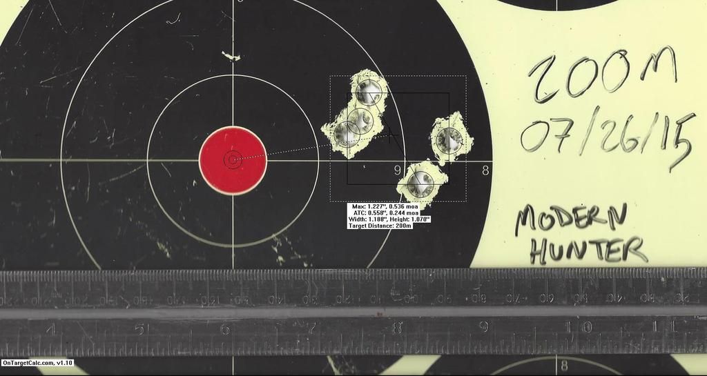

After shooting those three groups, I pulled out the allen keys and adjusted my stock, increased the length of pull by an inch and a half, and the position of my cheek rest and found my groove.
Once I got the stock adjusted, you can see the last two groups improved a bit. I ran out of paper at 100m so pushed out to 200m, and things only got better.
At .86 moa using factory ammo, with 250 rounds since cleaning, and with a hot barrel... I was pretty happy.
