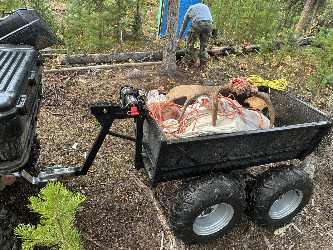

Got a similar system on my moose trailer except the winch is mounted on the front of the trailer itself. I think I'm up to 7-8 moose with this system so far.
Yes it does. The original ideas was to be able to drop the tailgate and add an extra 1.5’ to the bed but in reality that puts too much weight to the rear and will actually lift the rear of the quad off the ground! It does drop down bellow parallel and acts as a ramp.

We got this trailer last year from Princess Auto and love it. It has a drop down tailgate and a removable front. Used it for several elk now. My buddies side by side doesn’t have a rear winch so we just pass the winch cable under the machine and winch right on. My Ranger has a rear winch and I can just winch on easy peasy. An excellent trailer.
