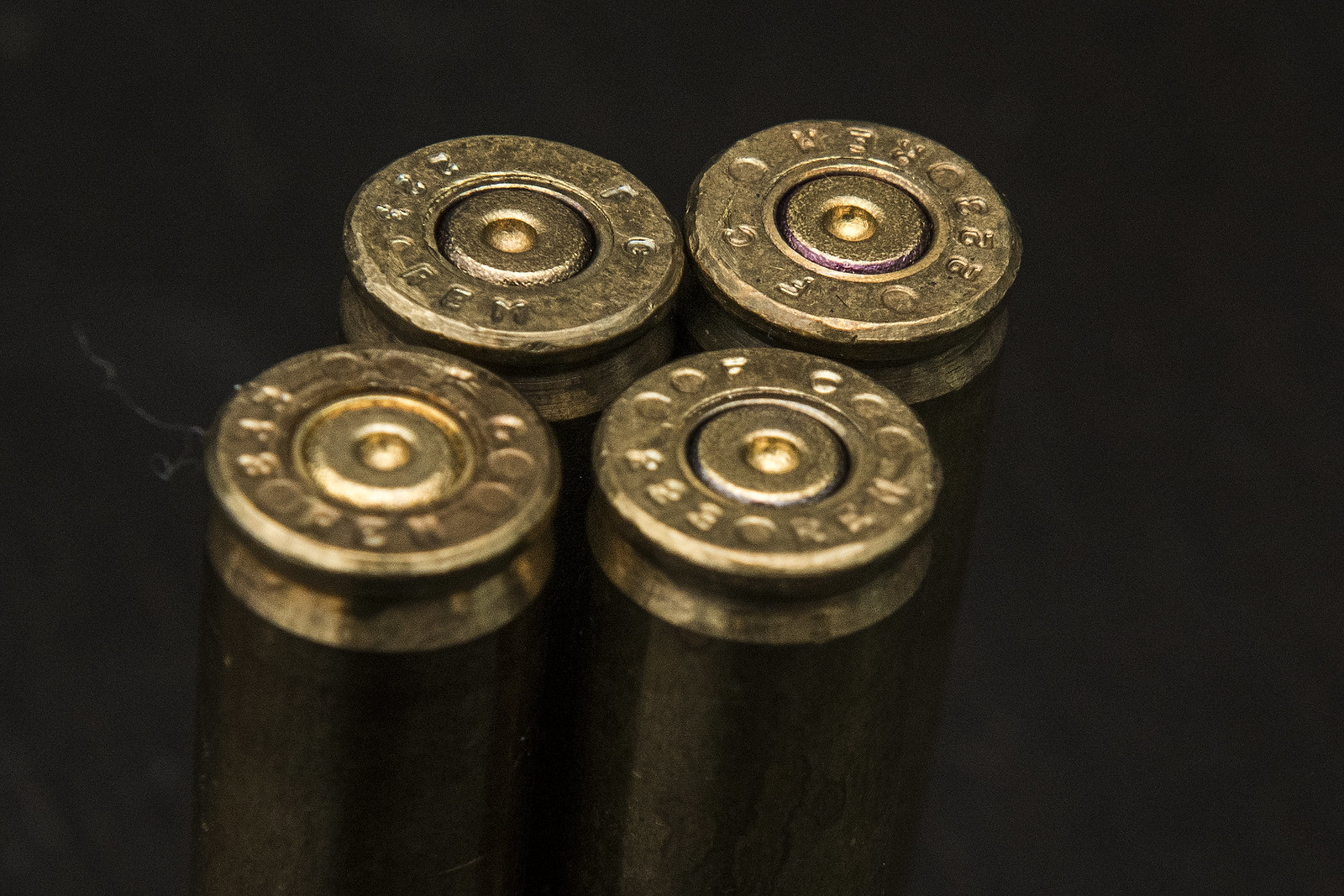

so when i first took this rifle out after receiving it, it would light strike occasionally. about 11 rounds out of the 250ish rounds i fired that day. i noticed that the primer dimples were unusually shallow compared to what i'm used to. even all of my fired brass exhibited the same shallow strikes. i gave it the benefit of the doubt that being a brand new rifle and platform, it needed to be broken in. also i was using new "milspec" american eagle "MSR" .223 ammo. so i figured i would try again later with my usual AE223 blackbox that i'm used to and never had a problem with.
another thing that i noticed and always registers is how light the hammerfall sounds compared to my AR
the light strikes from that day.

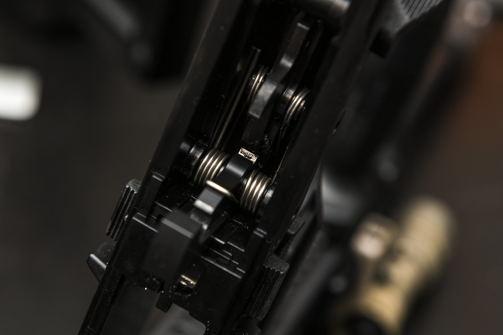

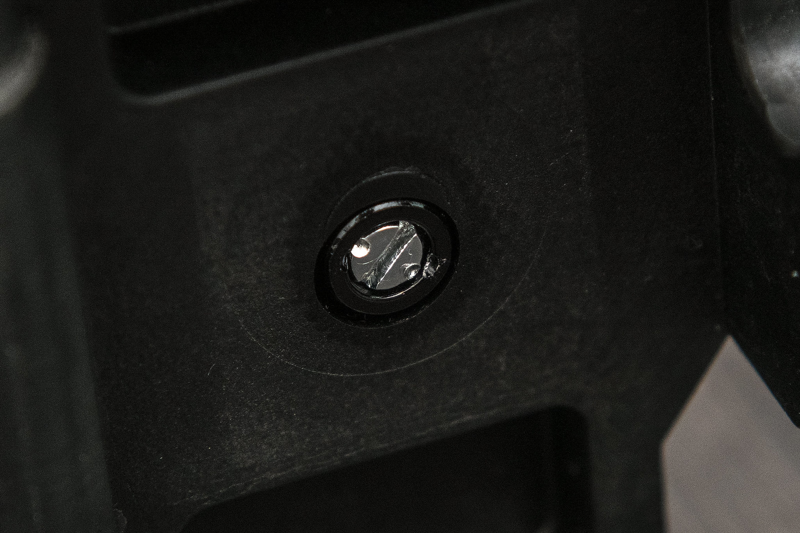

the next day i went to my LGS to pick up a heavier milspec AR trigger spring, to give it that same positive strike like on my mk18. i got home and swapped the spring, identical to an AR the install was easy. now to troubleshoot the bolt lockup. when i would rack the gun manually i noticed some fluid from under the sticker on the stock (oil?). it seems as the small silver screw backed out a bit and caused the leak, the staking didn't seem to grab it well. i emptied out what was left but now i'm wondering how to refill it? is it oil or something else?
new milspec spring
hydraulic buffer screw
so today i went out to see if my two problems have been fixed... no, not even by a long shot. worse than ever. it would seem that the spring made no difference. i recorded a lovely montage of some of my problems. this is in chronilogical order with only the in between pauses for hangfires and such edited out.

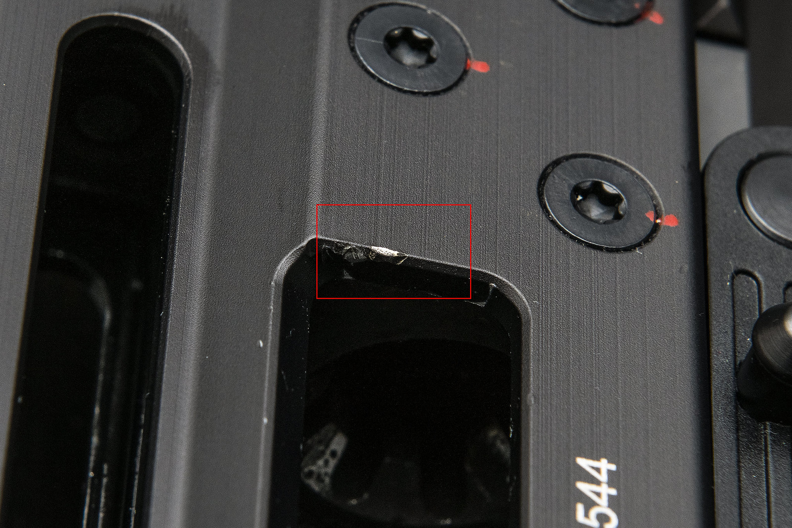

i noticed in the slow motion that some of the casing are rebounding off the shell deflector into the front of the ejection port as well. examples of that are at 3:06 in the video

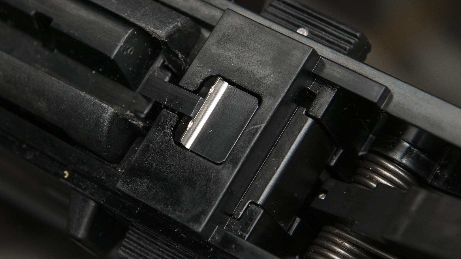

so clearly the milspec trigger spring was a bust. when i got home, i took the rifle down to put the old B&T spring back in and compare it to my AR. maybe the firing pin spring is too stiff? gunk in the firing pin channel not allowing the pin to fully protrude?
protrusion looks the same.
but these are from my AR
and this my APC
hammers and springs look the same. the DD one even functions fine in my APC but i'm sticking to the stock hammer and spring from now on.

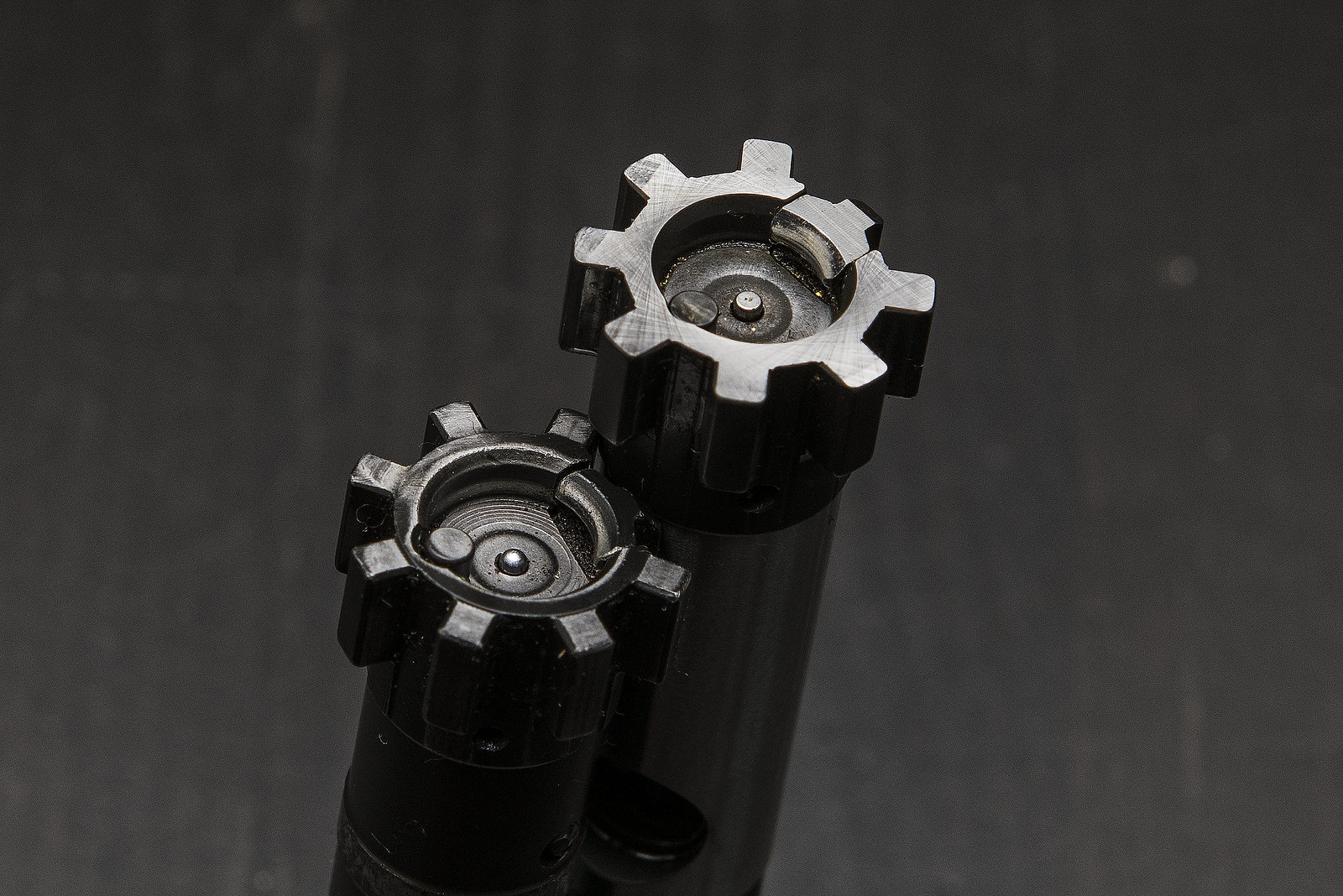

That firing pin is very flat and wide, thats a lot of increase in surface area. I bet a more round firing pin tip would solve the light strikes, increasing the force applied to the anvil in the primer.
That firing pin looks stupid.... I've never seen one with a FLAT face like that?? Also maybe check the firing pin channel to see if it's gunked up at all. If a stronger hammer spring didn't make a difference, it certainly could be the firing pin is out of spec. How heavy is the firing pin spring? it should be just enough to keep it rearward, not heavy enough to prohibit forward movement.

FWIW, my B&T Firing Pin is identical to the OP's. My shorty carbine functions 100% and is a terrific little shooter, so the problem is not an out of spec Firing Pin. At least not when compared to mine......

checked the channel. that picture is with the spring removed to see how far it would go, and compared to my AR it was equal. just flater. had 7 different mags out, you can see some of the different markings in the video. pmags, lancers and LAR.
the buffer is the odd one, it didn't even register to me that it may have been hydraulic fluid. i thought it was oil seeping. the manual is pretty light on technical info. i probably shouldn't have removed the screw when i found out it was loose to try to save the remaining fluid. i wonder if there is a way to refill it or the amount and type of fluid i'd need?

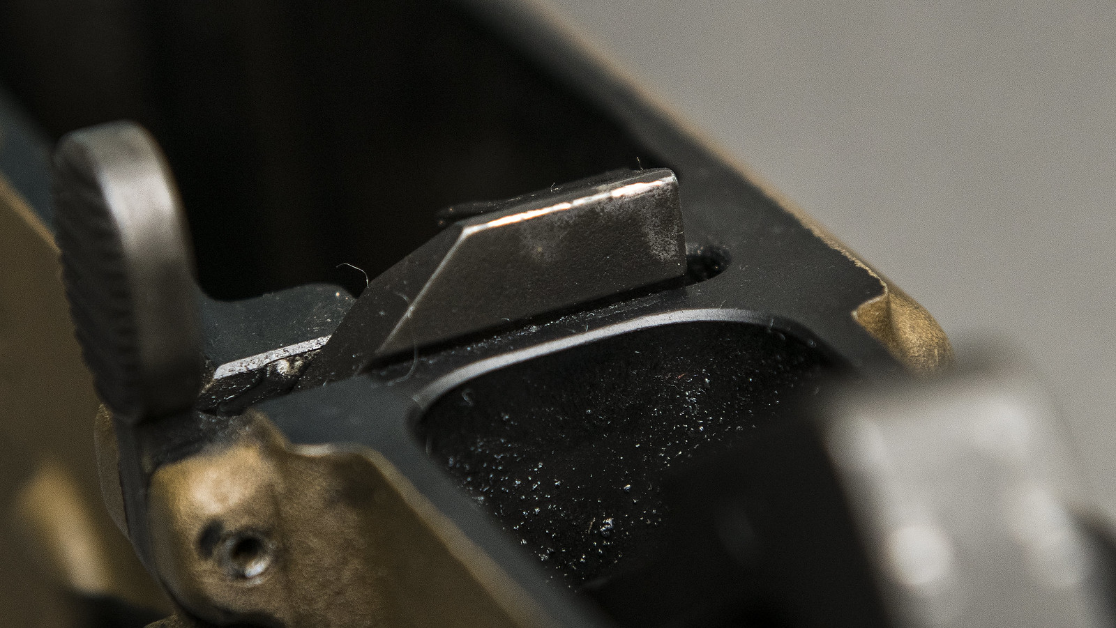

i checked the bolt catch. no damage, crisp catch and it will lock if i do it manually. before i noticed the leak, the charging handle did need to be pulled with some authority to lock open. there was some noticeable resistance. who knows, maybe there was too much pressure in the hydraulic and it blew out? its all speculative.

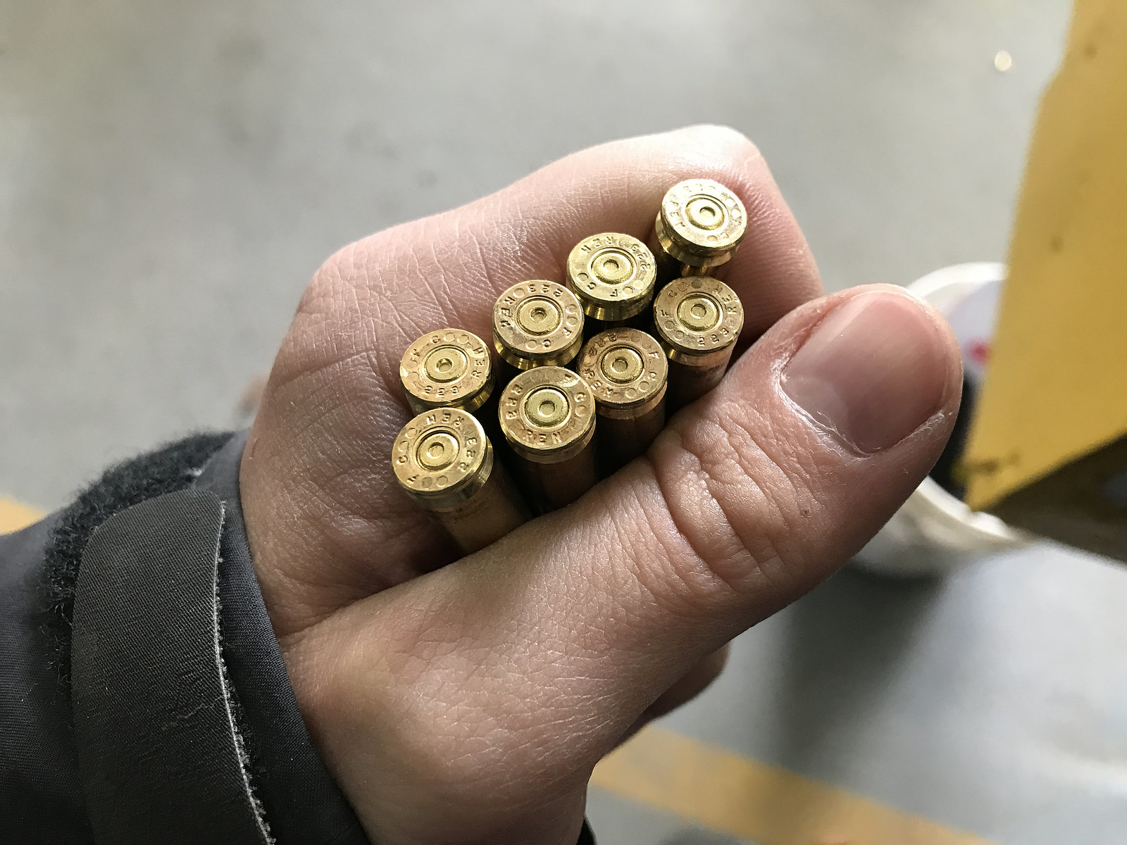

this isn't even all of my light strikes from that trip. i tried a second and even forth strike on 3 of them with no luck. the rest im saving to try in my mk18 and im positive they will fire.
X2 , i had a M305 that was having LPS and the FP looked flat and wide like that , in all my other rifles the FP looked very rounded . Swapped it out and the LPS were gone ..

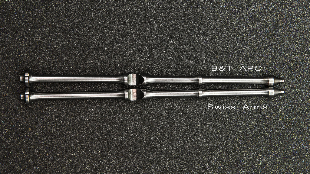

The firing pin and firing pin spring on the APC is the same to that used on the Swiss Arms PE-90s.
Same as in identical compared side by side. Same as in I’d be shocked to discover if they came in different packaging.
The firing pin signature and depth of protrusion on those fired cases is the same as what the Swiss Arms would produce.
I have never had a poor strike in probably 20,000 rounds out of a Swiss Arms rifle.
Having said that, the firing pin spring is quite tough, and in some cases it can be very difficult to compress the firing pin from the rear of the bolt with your finger. The springs on the trigger in the Swiss Arms rifles are up to the task, but they appear considerably more robust than AR trigger springs, and the B&T APC trigger looks not much different than an AR.
My first suggestion is to eliminate the obvious: strip the bolt and clean up the firing pin channel with some CLP and pipe cleaners. Make sure it is dry on re-assembly.
Inspect the firing pin spring and ensure there is no binding of it going over the ‘seat’ of the firing pin where it comes into contact with the firing pin retainer pin.
Test on assembly to ensure there is no binding on the pin with the bolt when you check protrusion by pushing on the rear of the pin.

B&Ts bolt catch
