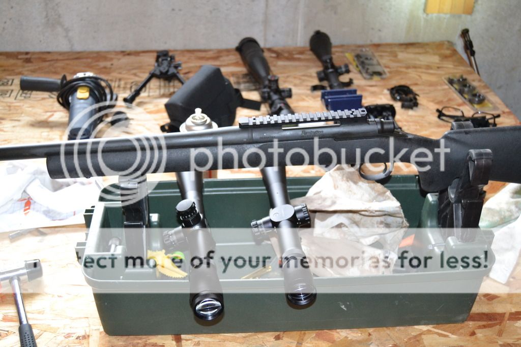

I'm not much of a Leupold user but I did have one available- a Mk4 LR/T 8.5-25x50 - which was a bit too new and powerful but would have to do. The sourcing of a suitable rifle was a bigger problem as my heavy barreled Remington's are so heavily customized that only the receiver remains Big Green. One Remington would sort of work - the R5 test mule I use for chassis reviews - but even that has aftermarket stock, trigger and bolt knob mmmm, what to do ?
While pondering this First World dilemma, I saw an opportunity to acquire a new in the box 700P in .300wm and, even better, a Leupold M4 3.5-10x40 with a mil-dot reticule. Both the rifle and scope were for sale at a good price so I now had the equipment needed for a retro 1980's look.

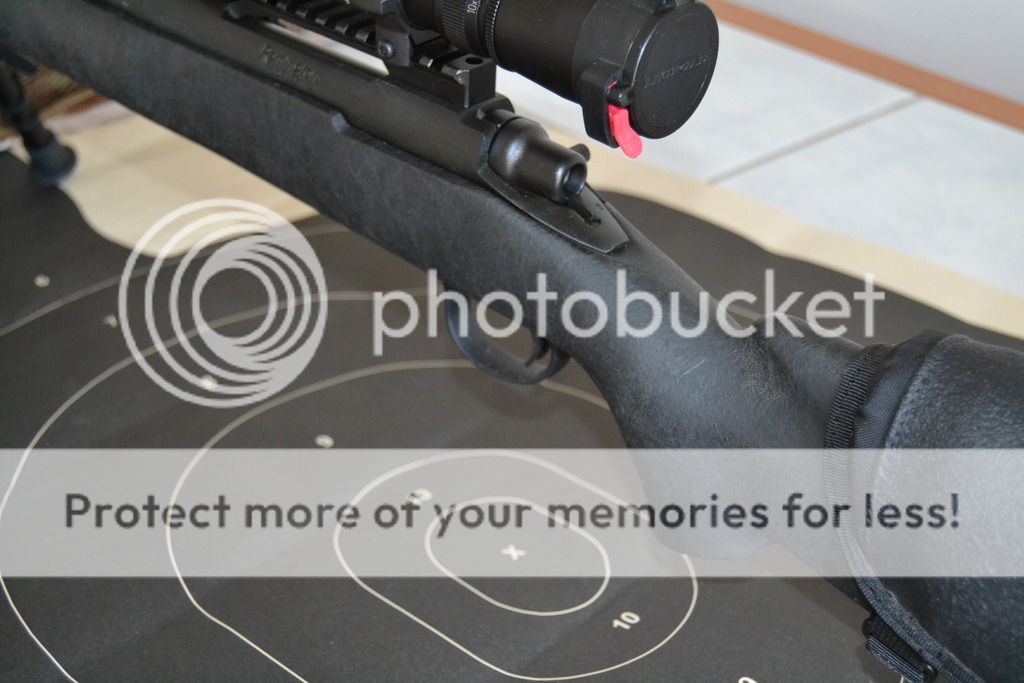

So what is the 700P like ? Well, cynics might say it is just a SPS sold for more money but actually it is a bit more than that. The rifle sits in a HS Precision stock that's made out of DuPont Kevlar and Fiberglass and is supposed to "stay dimensionally stable under the worst weather and tactical conditions". It is a very good stock and is similar but not the exact same as the stock supplied with the R5. The difference between the 700P and R5 stocks is in the pistol grip - the 700P fits me just right whereas the R5 is a tad short and therefore got replaced with the B&C A3 on mine.
The 700P stock comes standard with a wide forend for shooting off bags, two swivels that allow for the attachment of both sling and bipod and, like many good stocks, has an aluminum bedding block that runs the length of the stock. Other than the stock, the other remaining and obvious difference between the P and the SPS is barrel length as all the 700P's come with a 26" barrel. I've heard it said that the Police versions are better assembled but I've never seen a source for that so I'm skeptical.
This particular rifle looked to be finished well and the black coating seems to be evenly applied and the rifle sat perfectly in its stock. Everything appeared to be in perfect order.

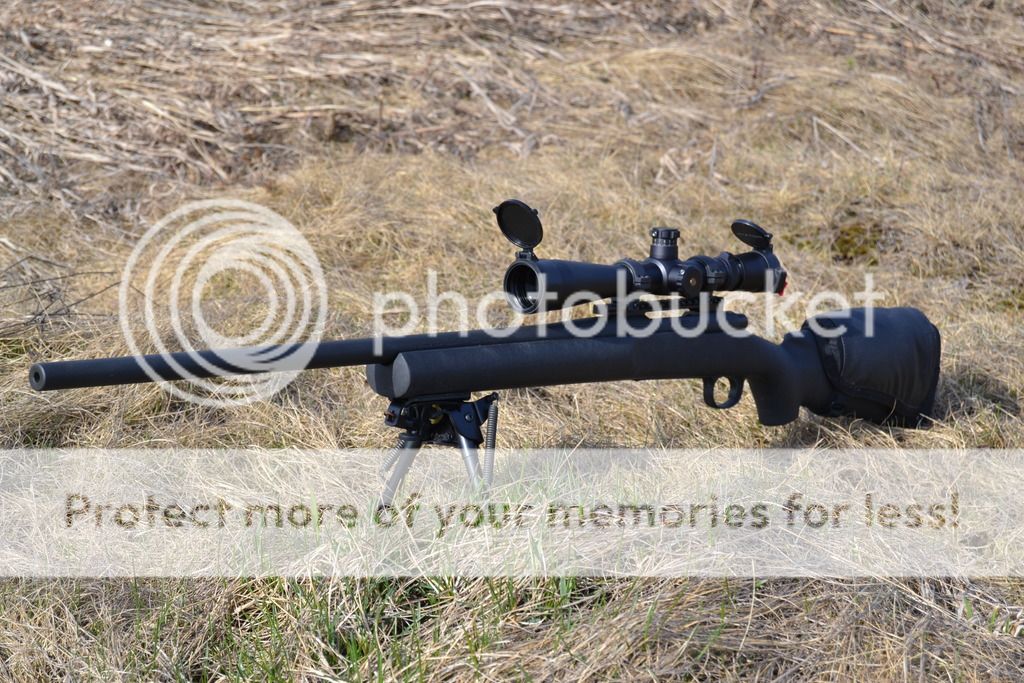

In the 80's we used two piece bases to attach scope rings to our rifles but this time I decided to make a concession to modernity and utilised the very popular Talley 20MOA steel rail. To bolt the scope on to the rail I used a set of Burris Signature Zee steel rings. Burris are not my favorite of rings but the plastic inserts are useful and certainly prevent maring of the scope tubes. As a matter of note I really like the rings from Tactical Precision Systems and consider them the 'value buy' amongst quality rings.
Finishing touches of a Harris type S 6-9 with Podlock at the front end and a Blackhawk cheekpiece at the other and it was off to the bottom hayfield to see how this old school set up would feel and perform when compared to more modern systems.

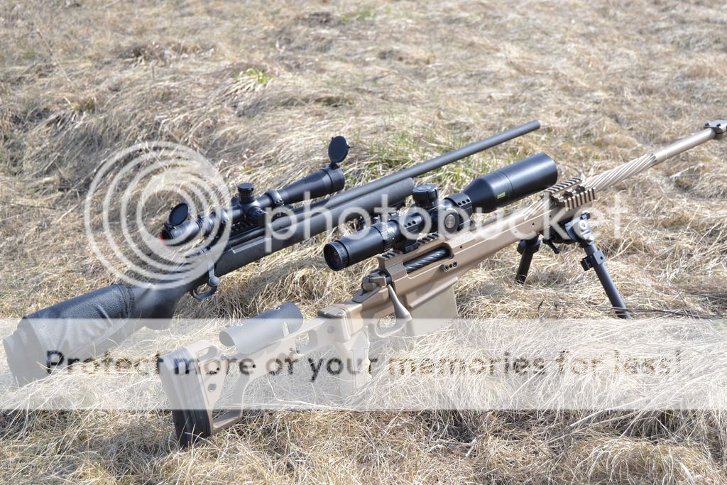

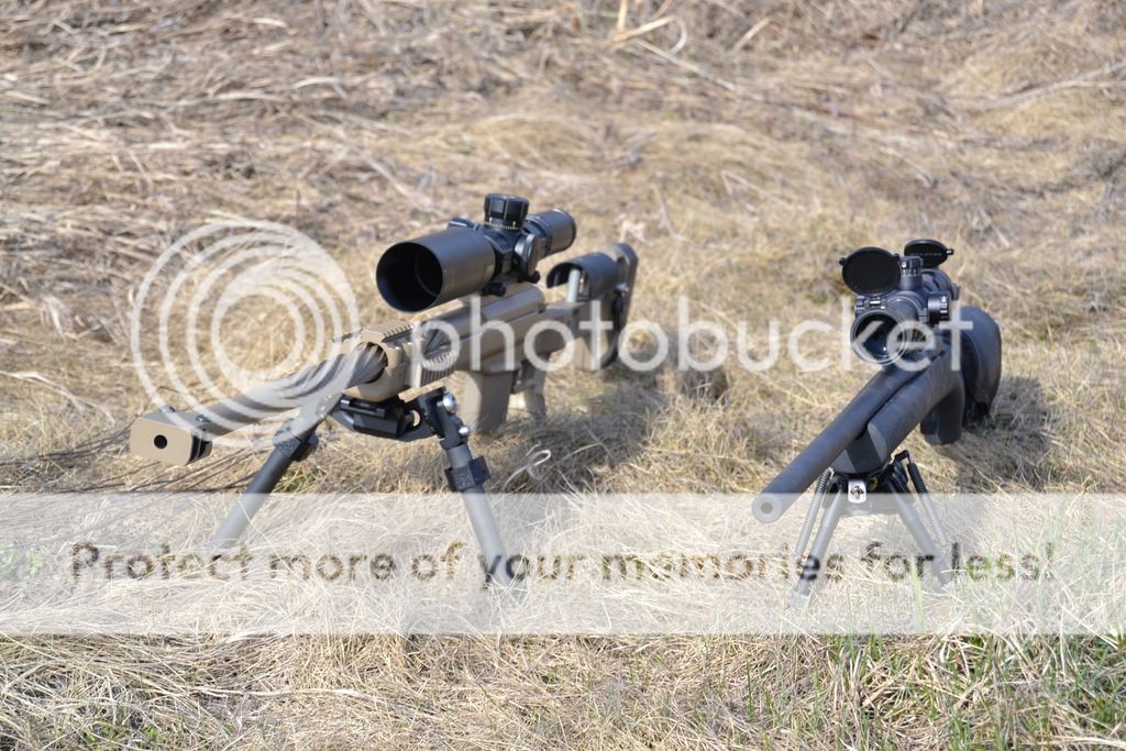

So at day's end what did I think of stepping back into the shooting world of 30 years ago? Of course, let's state the big flaw in the experiment: I'm not using real 1980's equipment but, rather, gear that replicates some of the best gear available in those days. Clearly, however, times have changed - especially since 2001 and the wars in Afghanistan and Iraq - so today it's simply true that there are rifles and scopes available to today's marksmen that have many more features. A team that wanted to buy a long arm/scope combo today would be looking for rifle with detachable magazines, threaded muzzle (for suppressor ), ergonomically adjustable stock with accessory rails for NV gear etc. Likewise, the scope choice of today's buyer may well encompass FFP, glass with more magnification and a better reticule choice.
Lack of features that some would deem essential doesn't necessarily mean that a shooter should automatically give these Old-School items a pass. Certainly both the 700P and a Leupold Mk4 remain powerful tools for Law Enforcement and a good civilian shooter will likely punch just as many V-Bulls with a 700P as with other, more expensive, tactical rifles.
A big plus for the combination of a 700P and smaller Mk4 is simplicity and with simplicity comes weight or, more properly, the lack thereof. My PGW .338 Timberwolf SWS with a FFP Elite 3.5-21x56 certainly weighs a great deal more than does this retro gear.
