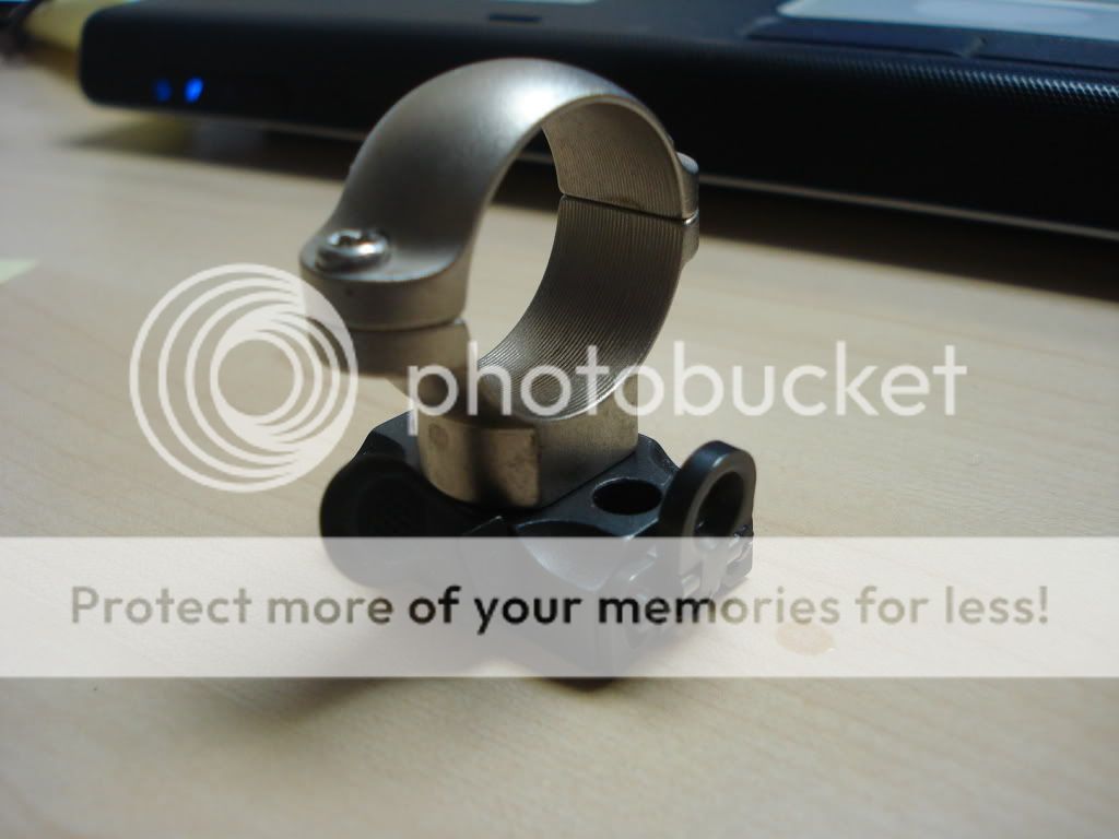

I prefer a peep sight, but do not like anything that you have to remove/re-install on a base, as I am as least as good at losing things as I am at breaking them.
Here's what I am switching to, Guntech mounted a Redfield flip-up peep on a Leupold QD base. It is adjustable in elevation and windage, and once sighted and locked in place with post-assembly lock-tite, it is pretty much indestructible, being mostly protected by the scope.
