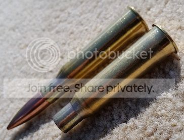

posting here because Im wondering if this would affect my ability to ever handload for this rifle. Anyways the rifle cycles well with steel cased surplus and mfs stuff from 150 to 203 grain. But last time I was out I shot some brass cased PPU through it and noticed it was much harder to extract than the steel cased stuff. I noticed that the case walls seemed hazy after firing, this doesn't occur in my old p17 308 target rifle with federal brass. I don't know if the haze is from expanding in a loose chamber or simply from chamber texture. Also I noticed 3 rings just beneath the shoulder that went approximately 80% around the case. I read a hornady reloading manual but still don't know what this means for sure. I don't know what this means for me or the future of this rifle so any insights would be appreciated.
The rings are hard to see but can just barely catch a fingernail.
