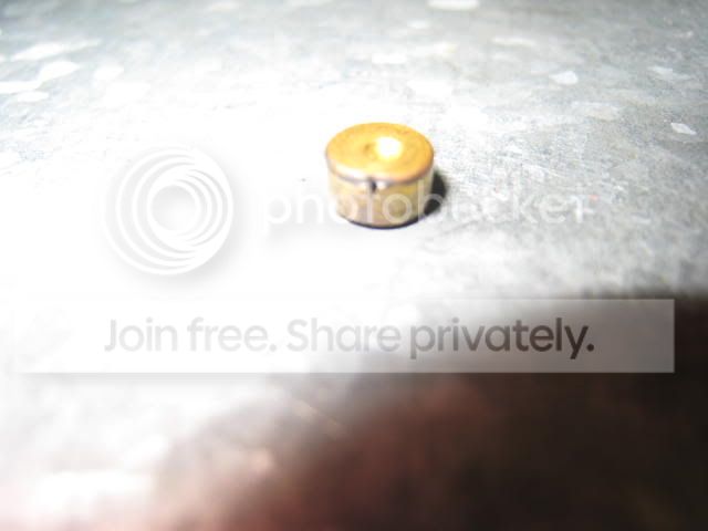

I just started using imr 4064 for my 30-06 with winchester large rifle primers and 150 Hornady ssts. When I started out I used 48 grs of powder and bumped it up in 0.5 gr intervals until I got to 51.5 which gave me best groups and no pressure signs. Anyway, last week while deer hunting I shot my deer and thought I noticed a little puff of smoke come out of the action (remington 7400).I just got the chance today to shoot it again and 2 of the 4 shells have burnt holes on the side of the primer and a little soot around them.I know I didn't overload them as I measure every charge and manual says 53.6 grs max and I am almost 2 grs under that and I shot almost a box sighting in with that load and none showed that.The only difference is it was a different lot # on the first primers compared to the second.I have read on other sites of people having problems with winchester primers and was wondering if any one here has had these problems?
