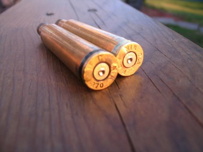

I tried some 150gr TSXs in my 270 w/o reading the fine print about lowering the starting loads. OOPS! :redface:
Now THIS is a flat primer. :D
I knew I was close......
