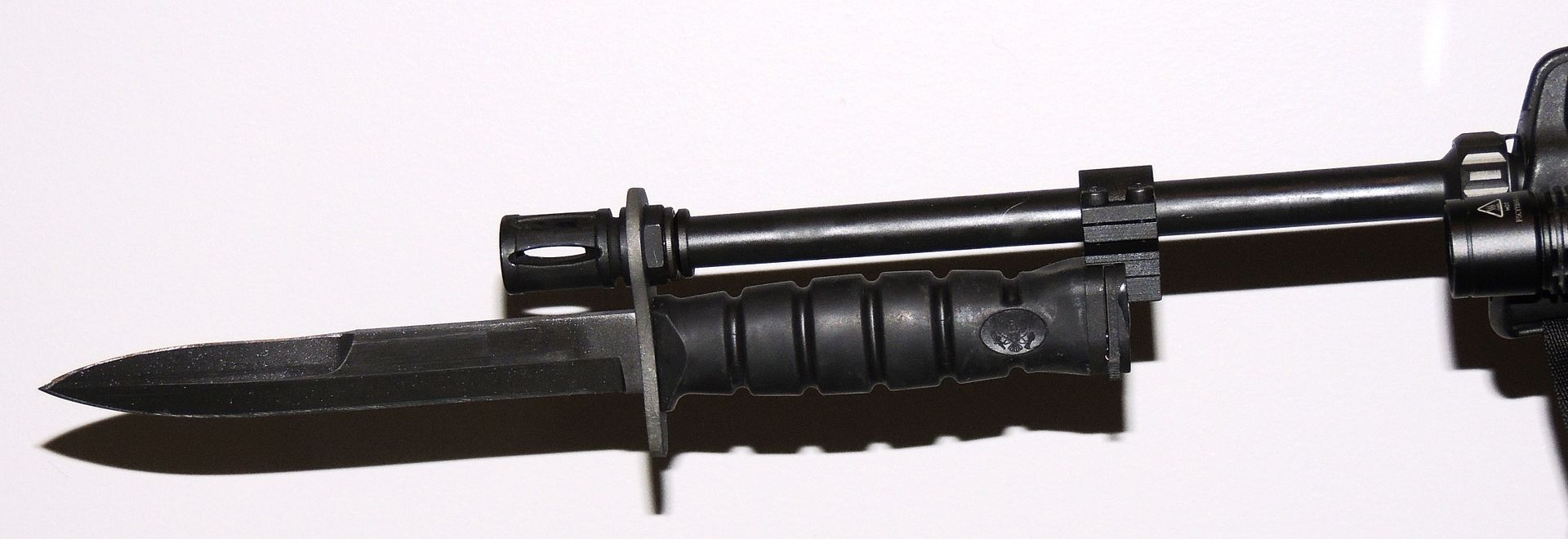

Barrel mount bayonet lug
To ShawnC6
They will work with Type 97. However original mount for Type 97 is on the gas block so for the mount bayonet handle needs to be shorten by 9mm. As long as the bayonet you would like to use has the back end secured with hex bolt that bayonet can easily be shorten. That how they look on type 97
Pm sent.
I might set that a bit further back. On my AR, the handguard ring ends up being in line with the rear of the flash hider.
The reason - with the setup you have, the muzzle flash is going to scorch the handle of the bayonet. At the very least, it's going to get covered in soot over time. Worst case, if it's a polymer grip, it will melt (especially if you do mag dumps).
