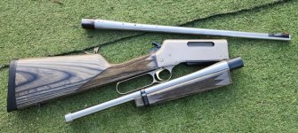

I want to shorten the stock barrel length and go with a bit bigger profile. Plus if I rebore, it takes away from being multi caliber.
Only machining that I foresee at this point is to open up the fore stock for the larger barrel.
I'm actually going to pick up a 308 TD BLR this weekend. Will keep up the thread for sure for those that are following.

Well the barrel nuts have landed.
Was able to purchase a 450 marlin magazine that will work perfect for my needs. Tracked down some 45 raptor brass as well.
Was able to push some of my 290 gr barnes TEZ tips into the brass for a comparison with the 450 bushmaster I shoot currently. I lucked out and the longer of them just happens to be magazine max and I can load out uptown there if required. Worst case I might need to fiddle with the feed ramp to get it to run smooth.
Now I just need a rifle and 45 raptor barrel.

While nothing great to update with, I did play with the magazines a bit more. I think that I will have to make a feed ramp in the 308 mag that is the same as the feed ramp in the 450 mag.
The physical size of the 450 is a tad wider, and longer with a less pronounced slant on the front, so it won't be an easy sway kinda thing. The follower is not the same shape either, as the 450 has the side grooves further in the front of it than the 308. Might have to either 3D print a new follower and feed ramp, or just grind the one in the 308 to make room for the feeding.
This is the 450 mag for reference sake with the feed ramp.
https://thegundealer.ca/product/browning-blr-450-marlin-magazine/
To boot there are not any barrels that are 45 cal out there, much less smiths with 45 raptor reamers. Might have to get someone sooner than later as they will probably have to order a barrel and reamers in.

As far as the gunsmithing goes, fitting a barrel to a barrel extension is not much different than fitting a barrel to a receiver. Never worked on a Browning takedown, but have installed barrels on AR-15 and Remington 760 barrel extensions. Instead of a receiver wrench, it is necessary to make a wrench that holds the barrel extension firmly. Metric threads on the barrel shank?
Yea threading the barrel onto the extension is not an issue, it is finding a smith with the proper barrel and the reamers at this point. It is basically like an AR type extension. Which is surprising why no one in Canada has felt the need to make any, which baffles me. Only guys I could find reference to is the one in Aus that I ordered from and one in Alaska. It is a machined part and then barrel blued, from what I could tell any ways.

I have sold the donor rifle already, and the extra stock I had, to good homes. The barrel nuts and a 450 marlin magazine are all that remain of the project at this point. They worked so nicely and seamlessly into the receiver, almost like the smith I bought them from knew what he was doing. With the TD rifle the barrel nut screws onto the barrel end. This slides into the receiver and the bolt then twist locks into it as it closes. Browning's positive lockup system for the BLR. Browning unfortunately does not make them available or any info on them. Only 2 smiths that I could come across that make them. One in Alaska and the other in Australia. Aust is way easier to deal with so I talked to them and ordered 2. I can't do video imbed, but if someone can I have a quick short vid of the new barrel nuts and how they work in the receiver.
If anyone wants to make a multi barrel BLR takedown in the 308 caliber bolt head, you can find the barrel nuts on gun p-st, under BLR search.
This all started with a search on a way to make a 45 raptor. Basically a 450 BM on roids. Same bullet, but an extra 1/8" longer brass, for a bit more oomph than the 450BM. I even went as far as acquiring an encore, and hoping to get a barrel made for that, but the ****** US tariffs put a stop to that. Nine35 basically told me they are not ordering from MGM while tariffs on, and MGM won't send to Canada. SSK doesn't make the 45 raptor.
