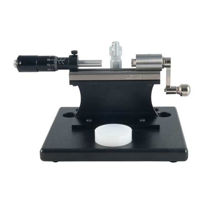

And some of the more well heeled use this one from Sinclair, Sinclair/LE Wilson Trimmer found here

I am using the Redding trimmer with the attached micrometer,a little more money but consistent lengths. Had a cheap trimmer before never again you get what you pay for usually
