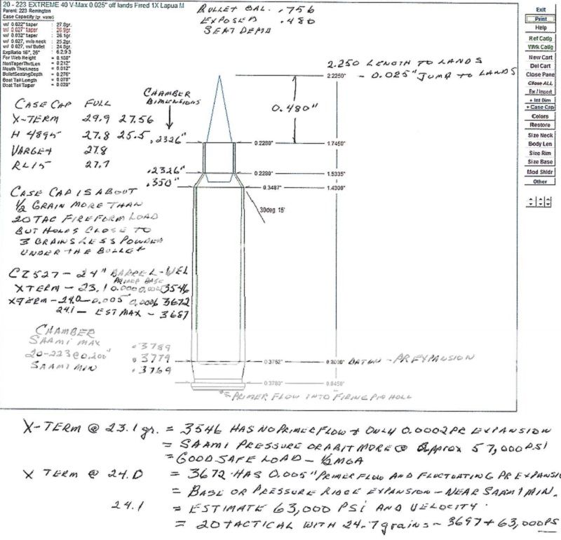

After about 8000 rounds through my original 20 EXTREME barrel I ran a minimum spec, 20 EXTREME, reamer 0.170" deeper into the chamber end and created a 20-223 EXTREME. What I found is that I created a 20 Practical that did not require moving the shoulder back or fireforming and was throated properly for the 32,39 and 40 grain bullets and still have them fit in a saami magazine. I know that the designer of the 20 Practical did this so he could use 223 Remington HS gauges and Bushing dies but can't understand why the designer of the 20 Tactical did what he did?
20-223 with 40 V-Max in a Lapua Brass. X-Terminator loads below show that 24.1 grains would be nearly equal to the 20 Tac Load and that 23.1 grains give a nice safe gopher load at 3546.
The X-Terminator loads showing that the 23.1 grain load is the best and a ladder with RL 10 showing that 21.7 grains running 3509 was generating more pressure than the 32.1 X-Terminator load.
