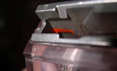

Here's a good fix for FTFeed. I tried it on 2 BC mags that wouldn't feed reliably with more than 20 rounds. Did a little light filing in the red area in the pic and they feed beautifully now even with 25 rounds loaded. It seems the casings can hang up in this area:
http://i47.photobucket.com/albums/f200/goose_25/25583SteelLips-med.jpg
Nice, if I have any issues with my replacements I'll try that. I already sent back my faulty two mags.
