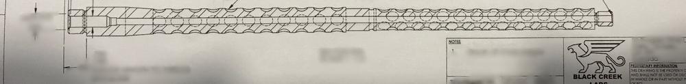

Interesting, but would rather see large straight flutes than the golf ball dimples. I imagine straight flutes would be less programming and machining time, probably would result in a lighter barrel as well.

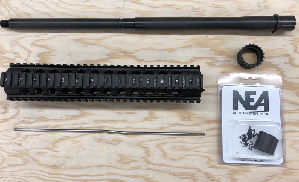

How about a gas tube, low pro gas block, 18.6” dimpled barrel (non fluted 18” one shown) and a $230 Troy quad rail for $450?
I would personally really prefer to not spend the extra on a rail that I will have to resell anyways....however, I do really like the idea of selling the barrel, tube, and block as a combo.
