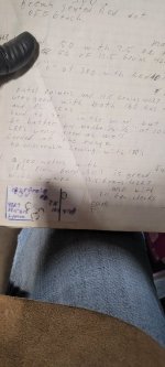

This is a 100 yard group shot with cast bullets and charges measured with an Uncle Mikes measure (basically the same Principle as the Lee Scoop) out of an old 8.15x56R on-site between shots
Pretty sure a scooped or thrown charge works okay🙂

Yeah that ain’t that great, if you’d use the latest in scale for sure this would be half that size man.. 🙄🥸🤣
