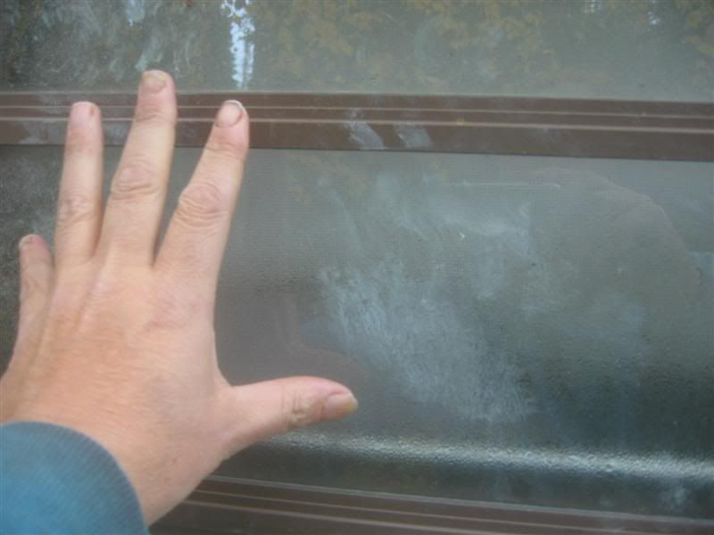

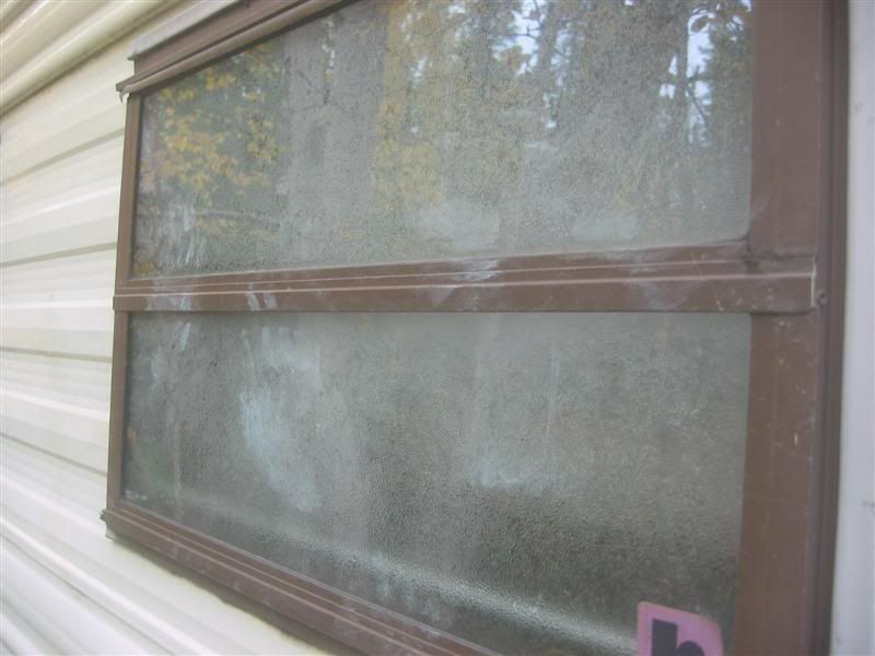

I'm getting tired of bears damaging my camper.
So... is this legal to do or could it be classified as harassing wildlife or something?
