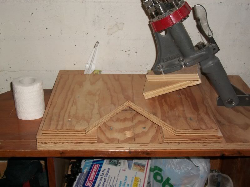

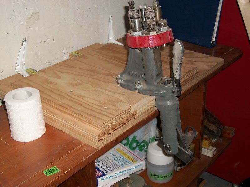

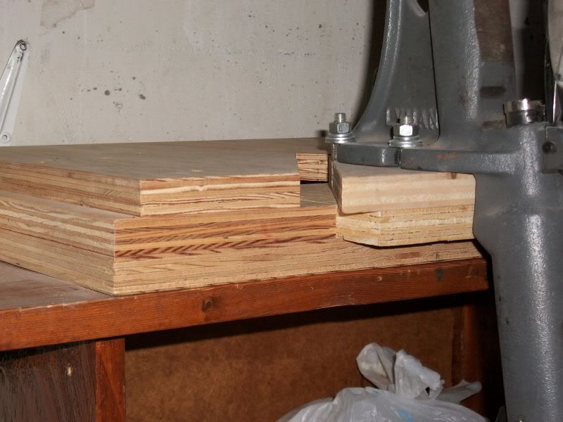

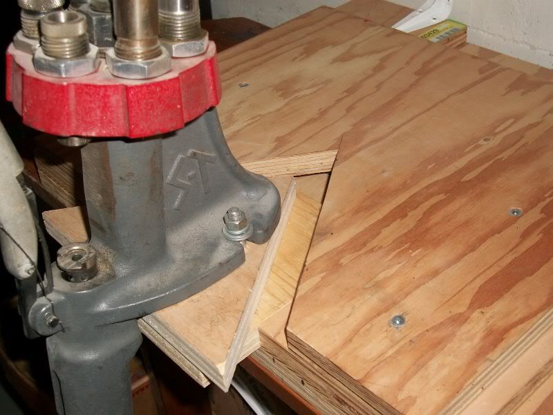

Here's my elementary set-up. As I said in earlier post, I plan to re-do the whole thing. When I made this, I didn't have much for tools. Now I do, and I can really make sawdust and firewood!!:p
