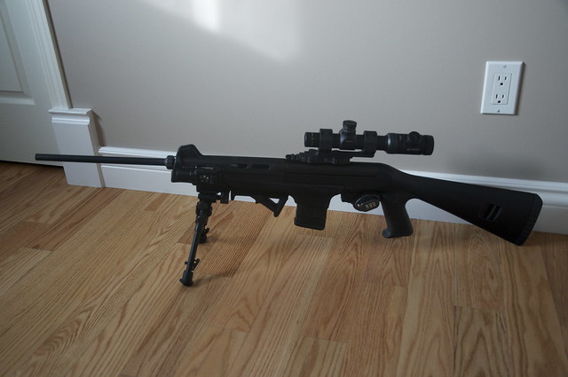

Back on subject though: Hit'r Miss- how did you mount a bipod without the railed forend?
There's an optional tri-rail you can get (identical to the one for the CX4 Storm). I'm still curious how he mounted the AFG.
tually factory installed. The AFG makes a huge difference in that it allows you to really pull the rifle into your shoulder. Actually, it wasn't that hard. The grip and rail are from Magpul (you probably knew that). I machined the rail to fit the contours of the handgard bottomside and simply used captive nuts (T-nuts) to hold it in place. It's a bit of fiddling to get the rail fitting perfectly but it's rock solid and looks virtually factory installed. The AFG makes a huge difference in that it allows you to really pull the rifle into your shoulder.
It toyed with this idea for months and then just said WTF. It was worth the gamble. Next is a top rail for the hand guard (shortened CX4 top rail)
Neat - you should post some pictures of it from the side. A CX4 top rail would probably be a great addition. Have you considered the folding/collapsible stock for it as well? All you need now is a barrel shroud.![]()
Fine bit of engineering. Well played. I like it, prob won't do it to mine... But it looks sweet.
Nicely done (in the above photos) - looks great!
Ahh- ok, I see the mount now.

My first set-up
My current set-up
