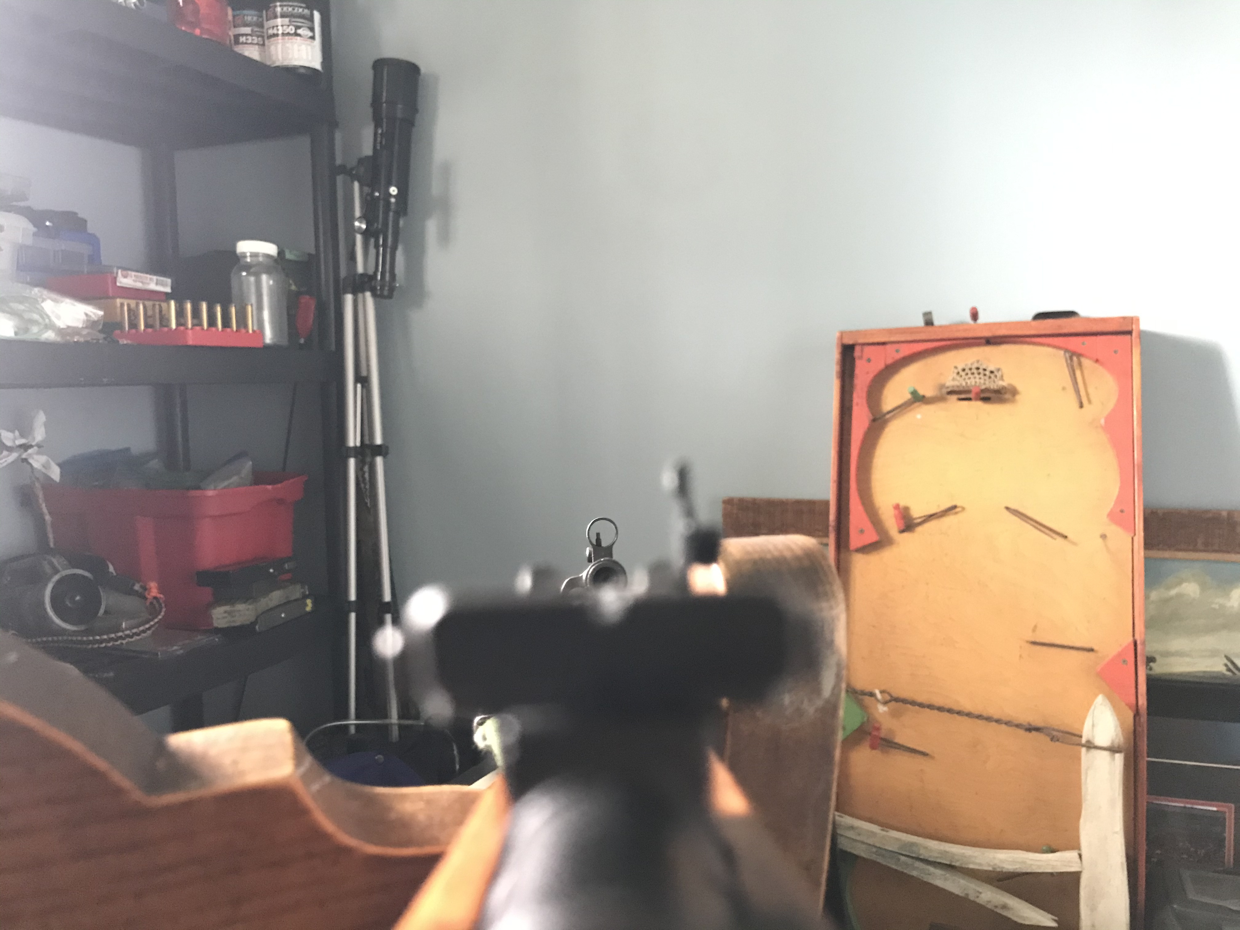

Picked up a ska a while back and at first thought the front sight block was canted but after measuring it on a flat auface the barrel is bent 1/8” to one side. I’ve seen the old bent barrel stg44 but still has me wondering if this is a safety issue at all or if there is some way to remedy this, a year ago I would just bought another but with prices lately that won’t happen. Seems to shoot ok 3-4” @100 but the sight pictures leaves a bit to be desired and I can’t zero the soft points that are locally available. Split the windage differences with a tech sight?

Hey Guys thanks for all the reply’s, when looking down its obvious it’s bent, fk. it’s hard to capture on photos but my buddy looking in person his first reply was dang Ivan dropped it. If I line up the middle of the reciever, from and rear gas blocks this how it’s sitting. Seems to shoot fine but curious if some premature wear will occur with a gun that see a lot of plinking. The post being way over within a circle kinda messes with my eyes too, might give it AK wings

Check out how far the front sight is drifted to compensate! Did you set the sight or did you buy it like that? Makes me think we really have hit bottom of the barrel on these.
North
North
I had to drift it over like that, it was still over a bit when I purchased it though. the post is hitting the sight block so there is no more adjustment or good clearance Works good for Chinese surplus I have bit the soft points shooting a bit left still. I think I’m gonna buck the wings half off like an ak, the offset circle and post really messes with me. Thanks 45acp, yeah I was wondering about the chrome as well. I’ll see how I like it with the sight hood modified a bit first but may take that route.
