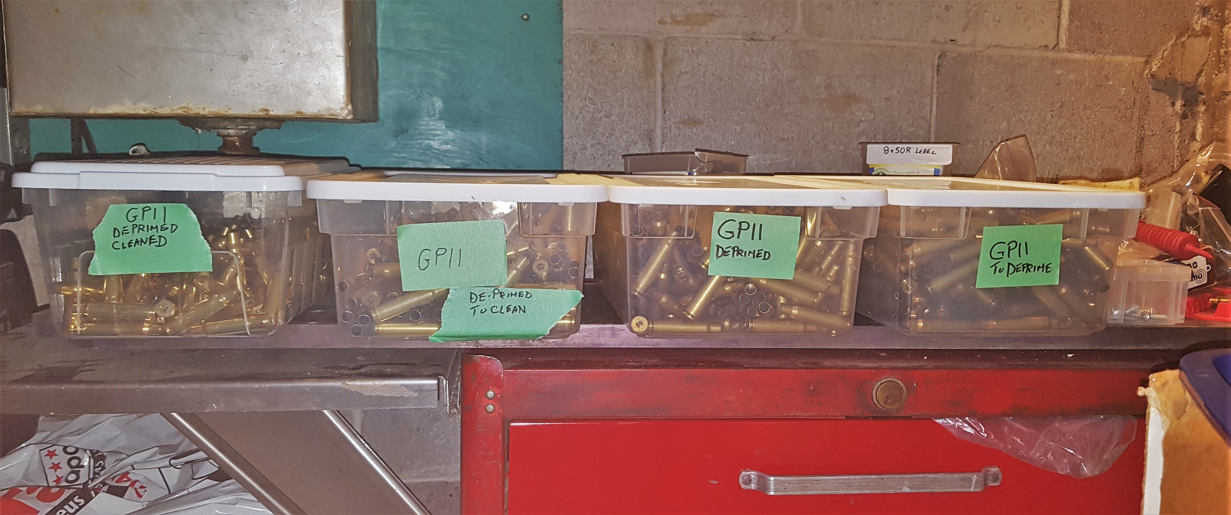

Keeps me from wasting too much time and money in strip bars. Wife is happy. :)
