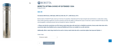

My understanding is that the tactical is shipped with improved cylinder but when I took it out to clean it say cylinder. Am I missing anything here lol.
They are usually advertised as coming with a cylinder bore, and come with the flush mounted Optima HP cylinder choke tube, same as yours (and mine). I have seen some of the US made 1301's that sell with 3 tubes (Cyl, mod, full) I believe.

Is this really the case with the 1301 according to Stoeger Canada?
Additionally, rifled or sabot slugs should not be used in a factory made choke tube with a constriction tighter than Improved Cylinder.
Are they just being too overly cautious?
They are not. These tubes are a few thou tighter than others in the same designation.
Having said that, I shoot rifled slugs through a modified Optima HP choke tube and all seems fine. No difference in accuracy between a slug through it and one through a cylinder bore one.
The same result of course doesn't hold true with buck shot. So, it'f you're wanting to shoot both loads on the fly, a compromise has to be found somewhere. For me, that's a mod choke.

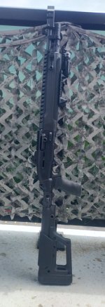

The 1301 is a great shotgun no doubt about it but an M4 killer it is not.Screenshot_20250824_135732_Gallery.jpg
