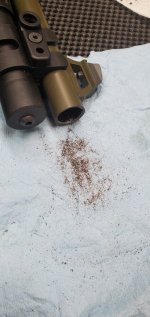

Like others have mentioned, it'll shoot almost anything just fine. But beware of the cheap slugs, I found they'll leave you cleaning a lot of lead buildup out of the barrel.
I’ve got a whole bunch of Rio slugs and they are horrible for leading
They are the Royal Star slugs, 1-1/8 oz velocity 1410 fps
I’m wondering if it’s the velocity that makes them lead really bad
Barrels are a right pain to clean afterwards
I have a bunch of Rio buckshot. Hope it's cleaner, but that's likely an unreasonable expectation.
