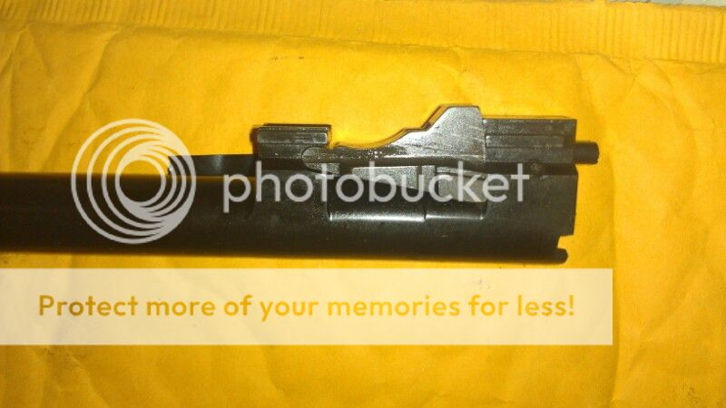

So not really a super high round count, but 17,000 is the recommend change up for the 92 FS locking block and decided to do a full spring swap as well.

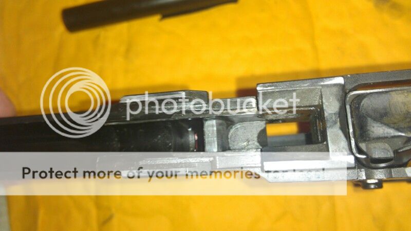

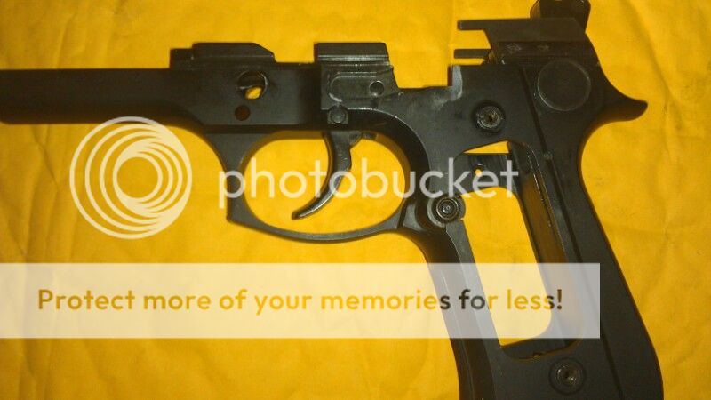

Overall she seems to be holding up well, a few points of contact where the bruntion finish has worn off. The locking block looks fine, I looked at it with a magnifying glass and I did not see any issues but did the swap. The hammer strut and sear looked new compared to a M9 with 100 rounds through it.

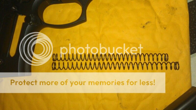

Compare the compression on the recoil spring. New one on the bottom.
A couple hints when replacing the springs on the slide, tear it down inside a freezer bag if you plan on keeping the old springs.
