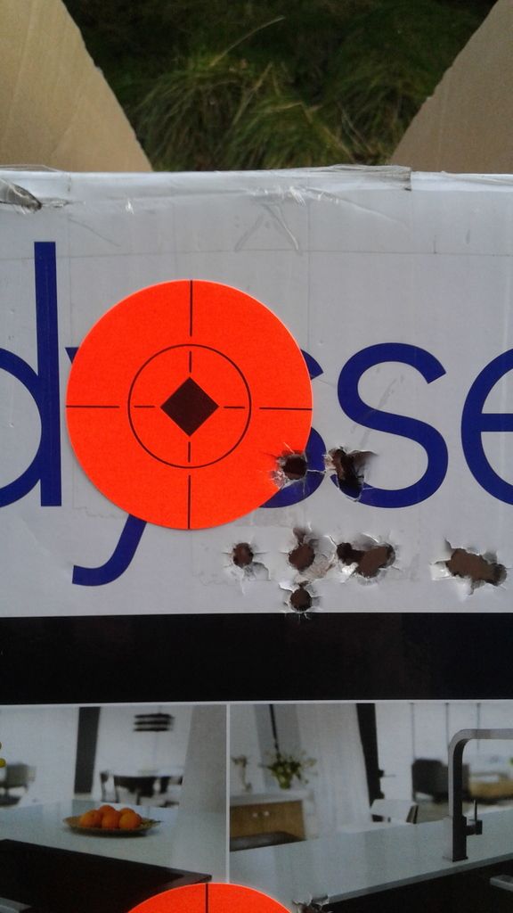

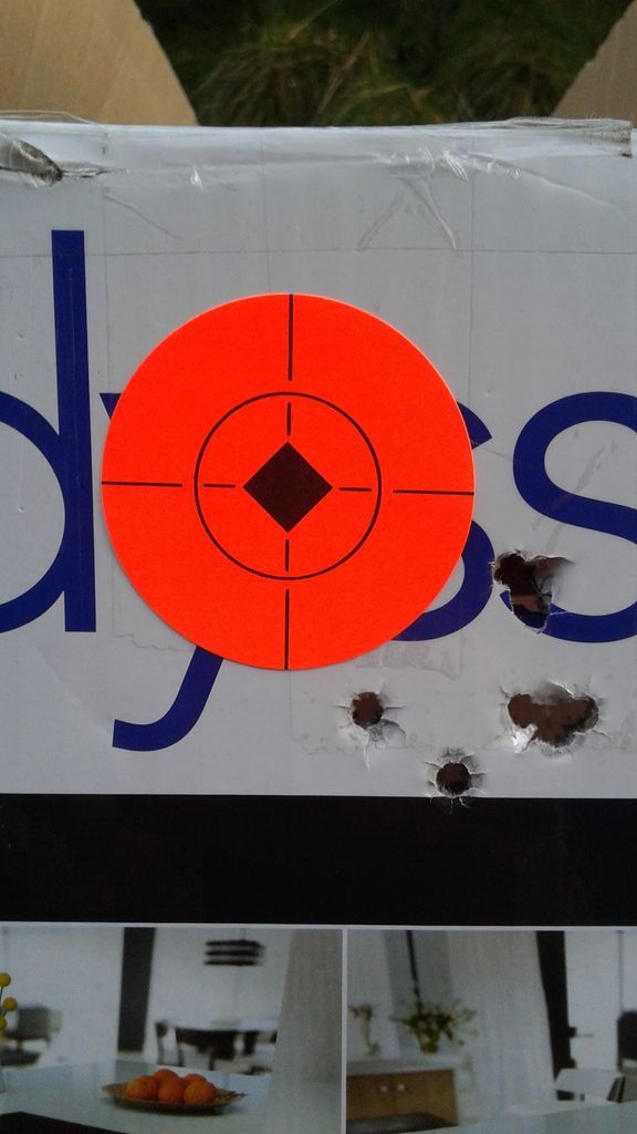

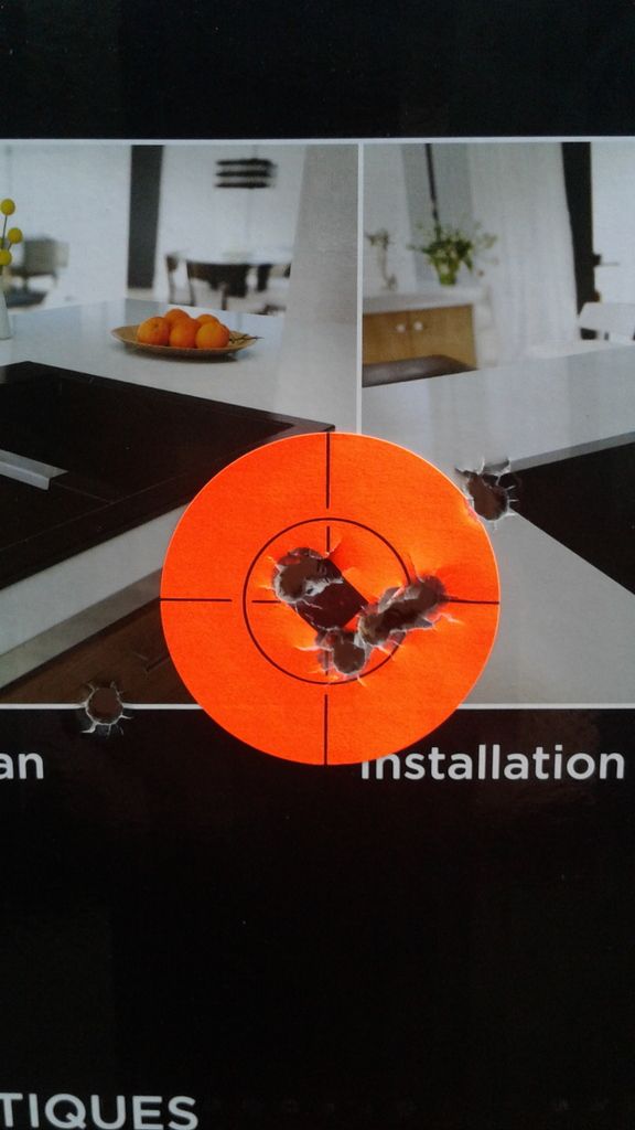

Okay! Got to the range.
Here are a few shots of the targets. Now, I'm not a great shot... but I think the evidence is here.

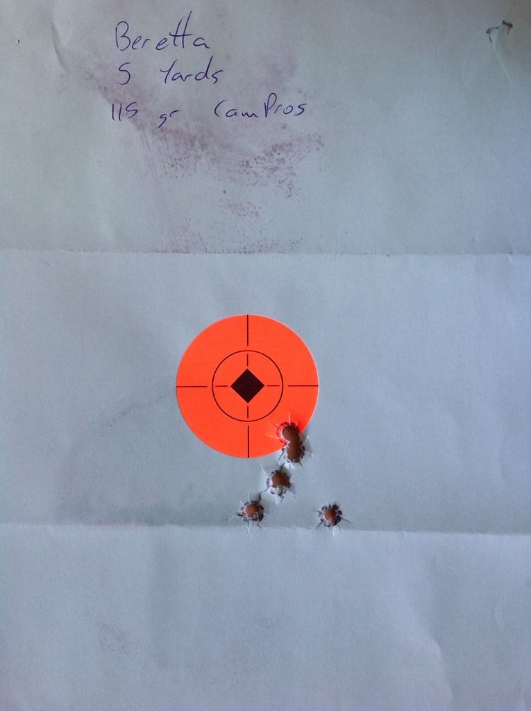

Beretta targets:

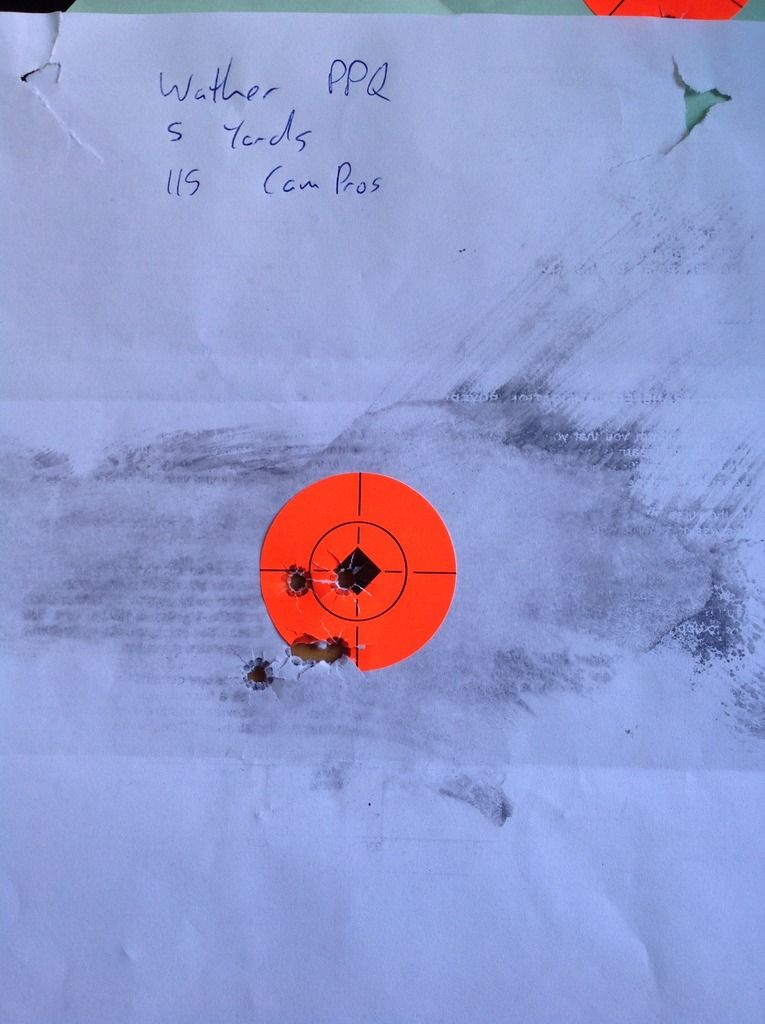

Walther Targets:
I believe there are five shots here.
What is interesting is the Walther shots are tending to land a little left.
I did some quick steel shooting afterwards with great success with the Walther, and several misses with the Beretta. I think I flinch a bit when I focus, maybe not at all shooting quickly at steel. Just a theory.

Seeing is believing. For whatever reason, your FS definitely shoots low and right. The trigger pull for you may or may not have something to do with it but that doesn't matter.
Seeing as you are grouping reasonably ok with the 92 and pretty good with the Q, you'll probably have to change the sights on the Beretta for your style of shooting. Don't discard the current sight. It may work for the next owner ( if there is one!)

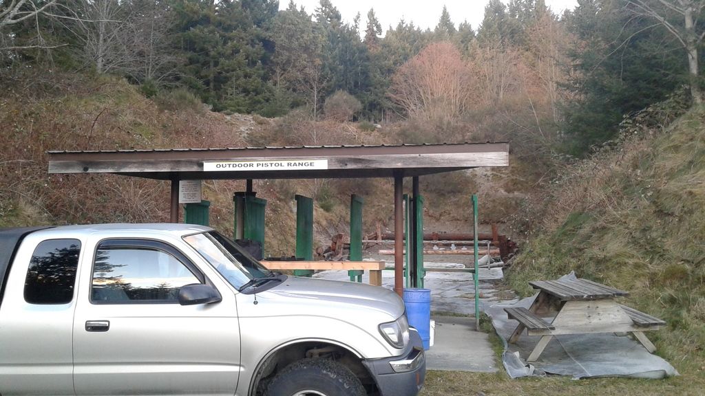

I am one of those lucky shooters with a range 5 minutes down the road. Hit the tripometer, and from my door to the shooting bench is 4.2k... Coming from Vancouver, I truly appreciate it:

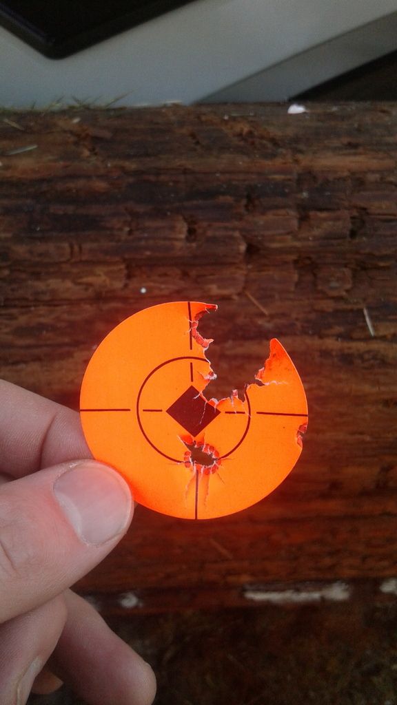

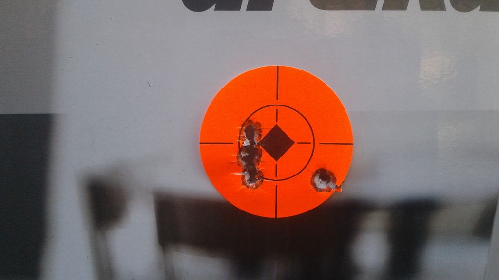

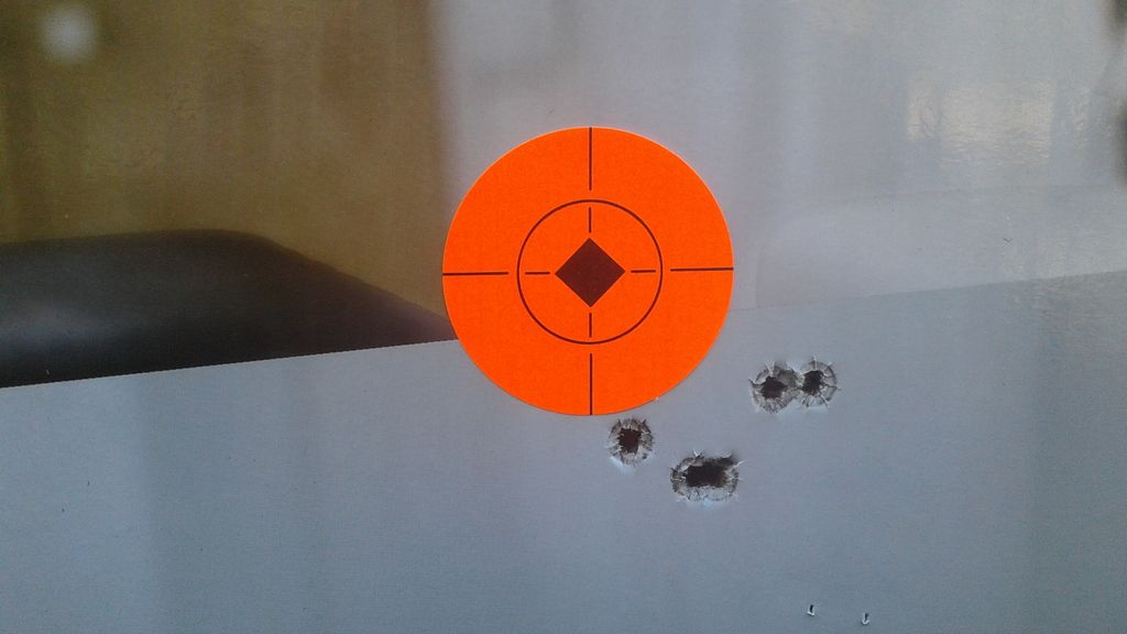

So here are some more results. Other than a couple promising groups, it is still low and right... which I figured would be the case. But had to double check after installing new mods.

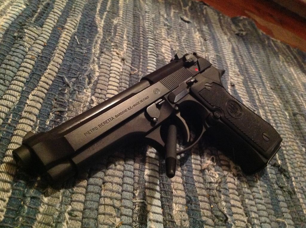

And obligatory picture of my 92F ;)
Are you aiming at the bottom, for a 6 o'clock hold? If so, the elevation is about perfect.
Drift the rear sight to the left about 4mm and it will hit the bottom of the disk. In other words, it will shoot point of aim.
Oops! I think you already asked that, and I failed to answer!
I am covering the bullseye with the front sight, so she is shooting low. I wish it weren't so!
Ooooo nice grips!
