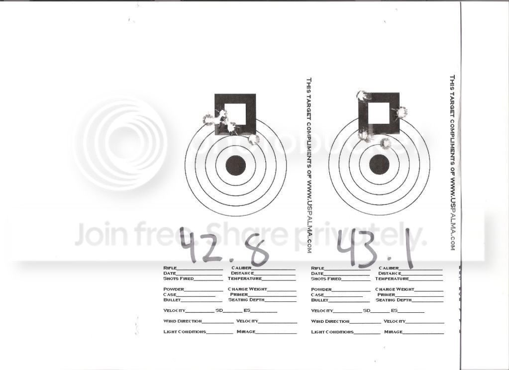

Well to my surprise the best results were at my starting point of 0.020" OFF the lands, as I progressed closer to the lands the groups opened up.Not at all what I expected.
Four shots touching and one 1/4" off.I will stick with this depth and tweak the charge a little and hopefully get a nice sweet spot.
Fail moment today was when I returned home and was going to remove my targets so I could record and measure, they blew off of my target board in the back of the truck!!
