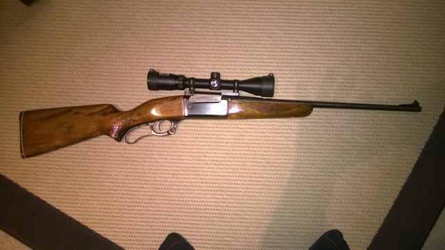

Pic of rifle for the curious.

the rifle looks good an doesn't need to be stressed, 150gr at over 2500fps is plenty.
