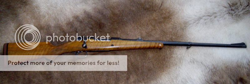

You won't be disappointed in a Model 46 9.3X57.
Fills the bill perfectly.
Teds
Very similar wood, Johnn, but a different rifle.
Ted
I was thinking of the wood blank I got from you. I had that set aside for a new stock for my .410 single shot 'ditch chicken' gun, that I have since parted with. May use that wood for the original purpose I had in mind for it, ;) now that the eyes are good.
