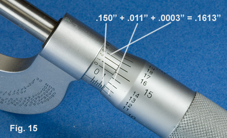

The problem I have is believing you trust a calliper to .0001”. Only one of the following is good to .0001 and it is not a calliper. In fact the first three will give you the same measurement but some will be quicker to read.

something to keep in mind. Vernier calipers are not meant to be accurate beyond .001 of an inch, if you want to get to .0001 you need a micrometer.
yes digital calipers say they measure to .0001 try measuring the same part 3 or 4 times, bet you wont get the exact same reading.

It's not easy to measure to .0001
You have to handle the micrometer like a pro. Even heat from you hand can throw off the reading.
Heat in the item to be measured will also throw different measurements also. And yes measuring to 1/10000 is not easy, can it be done repeatably you bet.
