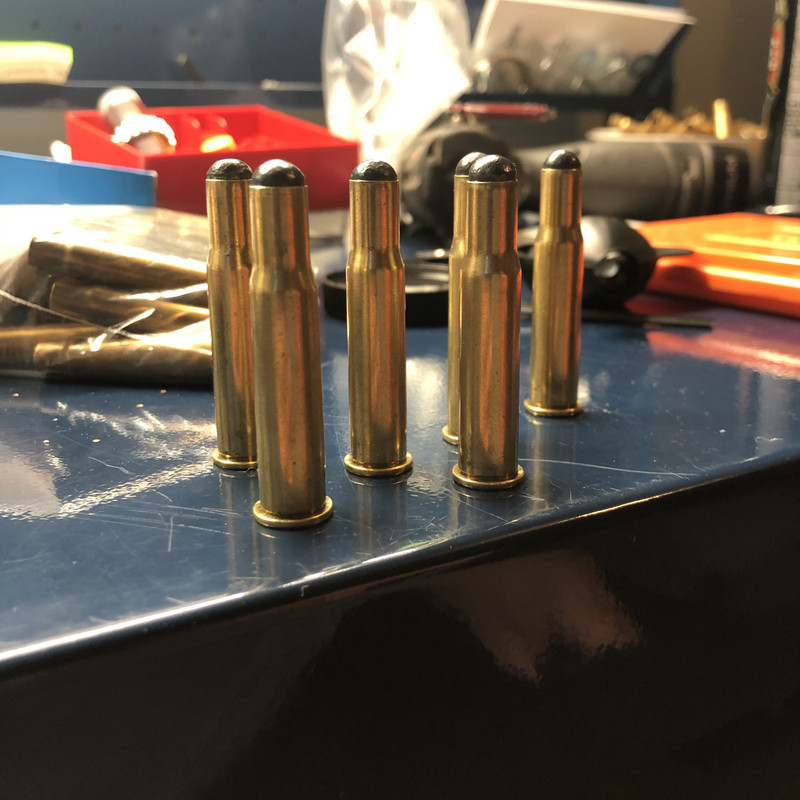

I made some up for my cousin’s 30-30 just last night:
