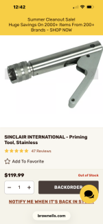

Started losing hand strength after retiring, need to do something different. Refuse to handle individual primers by hand, so, Sinclair, 21st, etc were out. Kept seeing stuff on Derraco, finally broke down and bought one, not cheap, but not Primal Rights type expense either.
See the Hornady bench unit out there now, and the Lyman autofeed bench version, don't much like the Hornady, it's another copy of a different older one, and it's overpriced. Lyman is good from all accts, asked a few people who bought them what they thought, they liked it, worked properly and easily, they'd buy again. FA hand unit is OK if it fits you, RCBS is better ergonomically for me, universal is OK, didn't like the way brass cocked on initial seating of the primer. I tried a new Lee handprimer, it was a puzzle, could not get it to feed, multiple tries at it considered it a lost cause, which cancelled out trying their bench unit too. I still have 4-5 old Lee rd trays, the 21st and the Forster, can also use the Co-Ax or Rockchucker if desperate. But, the Derraco PCPS is a really well made and intuitive unit, well worth the loot. I can use it at home on the presses, or at the range, on a Lee hand press, or others.. Would like to have had it a lot of yrs ago.

Sinclair hand priming too is nice but there is no way, I would touch the primer and singlely hand priming each of them. Time is too precious for that.
