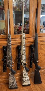

Ah, so it "begins"... I "started" with a Tikka T3x SuperLite in 30-06... Now I have a 300wsm & 7mm Rem Mag as well...
ALL have Bushnell Elite 4500 2.5-10x40 (30mm tube) scopes with medium height Leupold Backcountry rings. IIRC I paid ~$350 for the scopes...
So there's my recommendation AND, the T3x thing is an addiction, lol!

My 30-06 is a Special Edition T3x SuperLite in TrueTimber VSX, stainless & fluted barrel, it's easy to shoot.
The 7mm Rem Mag is a cerakoted T3x Lite Alpine Veil with a muzzle brake, again it's easy to shoot. Just LOUD...
And that brings me to the 300wsm... It's the s3xiest wsm IMHO... Mine's a T3x Lite that's plain black synthetic blued and probably the most recoil I can comfortably shoot off the bench lol! It has a very sharp recoil pulse, but I had to have a 300 wsm!
