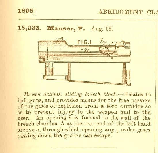

All military actions have that thumb notch. It weakens the sidewall......
It also vents escaping gas from a case failure out of that sidewall before any high-pressure gas reaches the bolt shroud, and does so while still allowing cartridges capable of producing greater than 50,000 psi chamber pressure to be fired safely.
Ted
Ted
Exactly Ted. Not only was Paul Mauser a design genius, he seemed to be a good businessman. Apparently he patented virtually all(or most of) the features of of his firearms.
Below is the patent that deal with the so called ‘thumb notch’.
